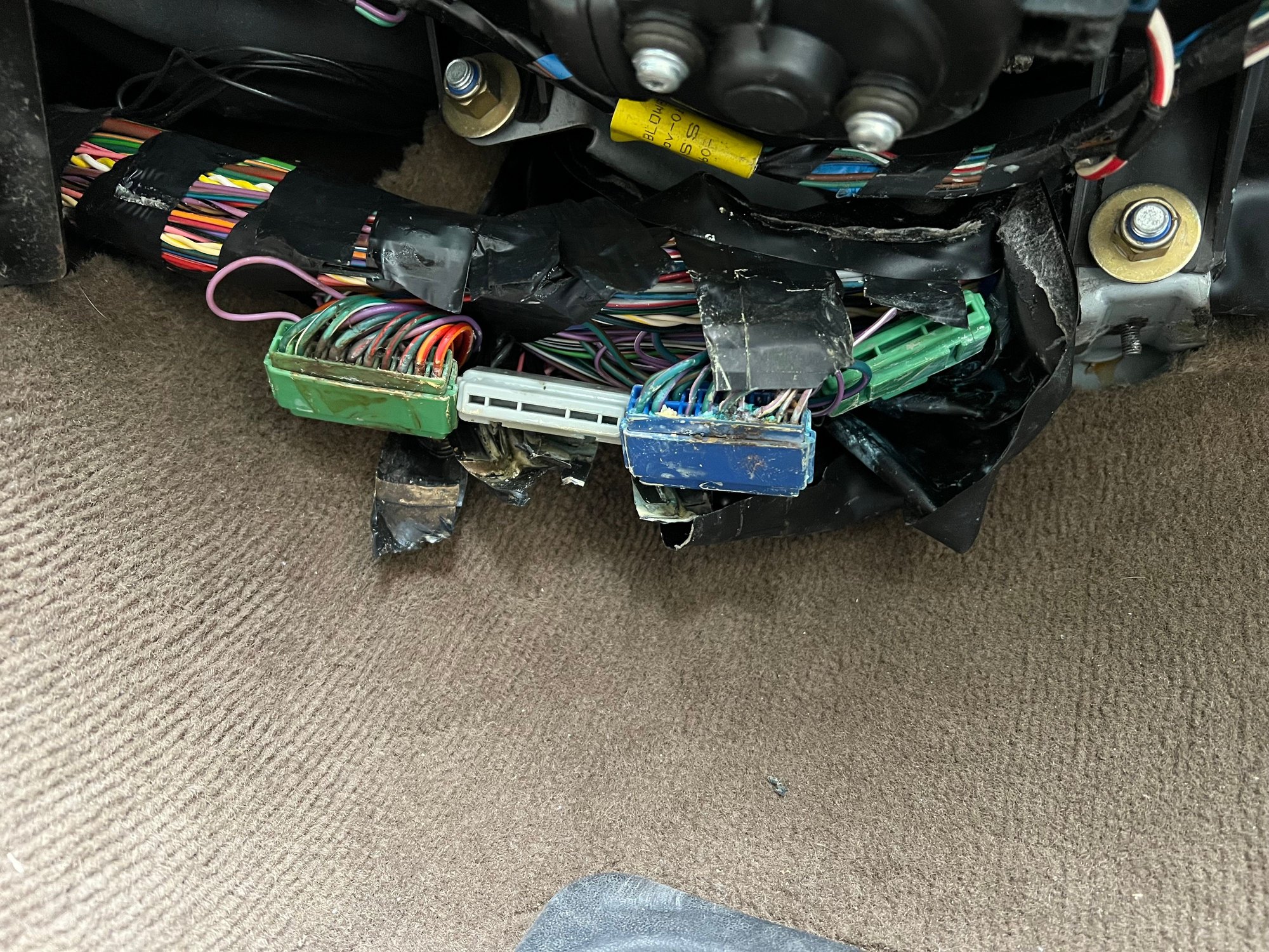

Thanks for getting back. This helped me narrow my issue to C0287 — the blue connector in black wrap under the glove box. Looks like the Rover engineers saw fit to stick this connector at the lowest point on what would inevitably become a non-draining gutter. This one connector is in terrible shape, surprisingly the others beside it are pretty well intact. Just glad it wasn't the BCU!

Glad you found it. It looks terrible!
