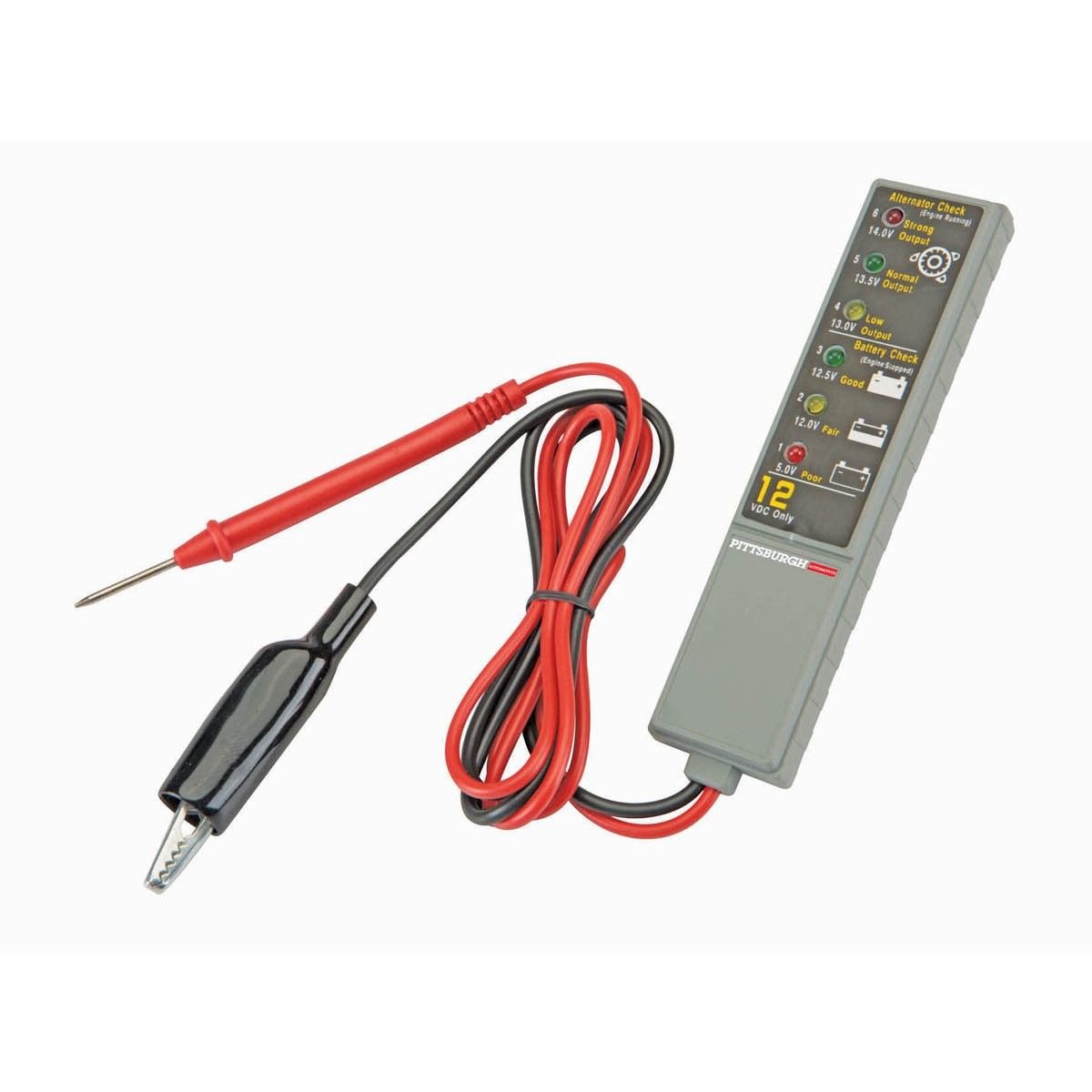

I recommend getting the cheap battery/alternator tester from Harbor Freight. It is only 4.99 and I have had one for 10 or more years. You can check the voltage before startup, then at idle.

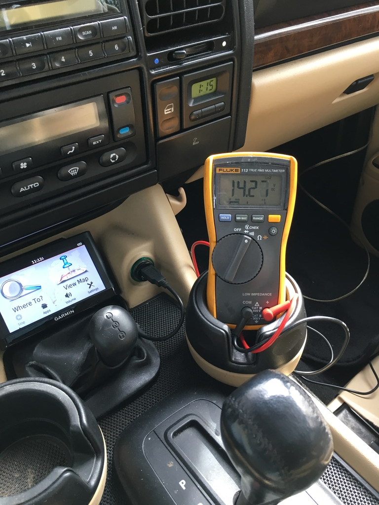

Rigged up the voltmeter inside the truck with leads to the body ground and the positive battery cable. Drove the truck watching the dash, and the meter. Voltage was a consistent 14.2 - 14.6 depending on RPM. Never dropped below 14.2. Battery light flashed when I revved the motor in park, or when I accelerated. The light flashed regardless of the voltage.
