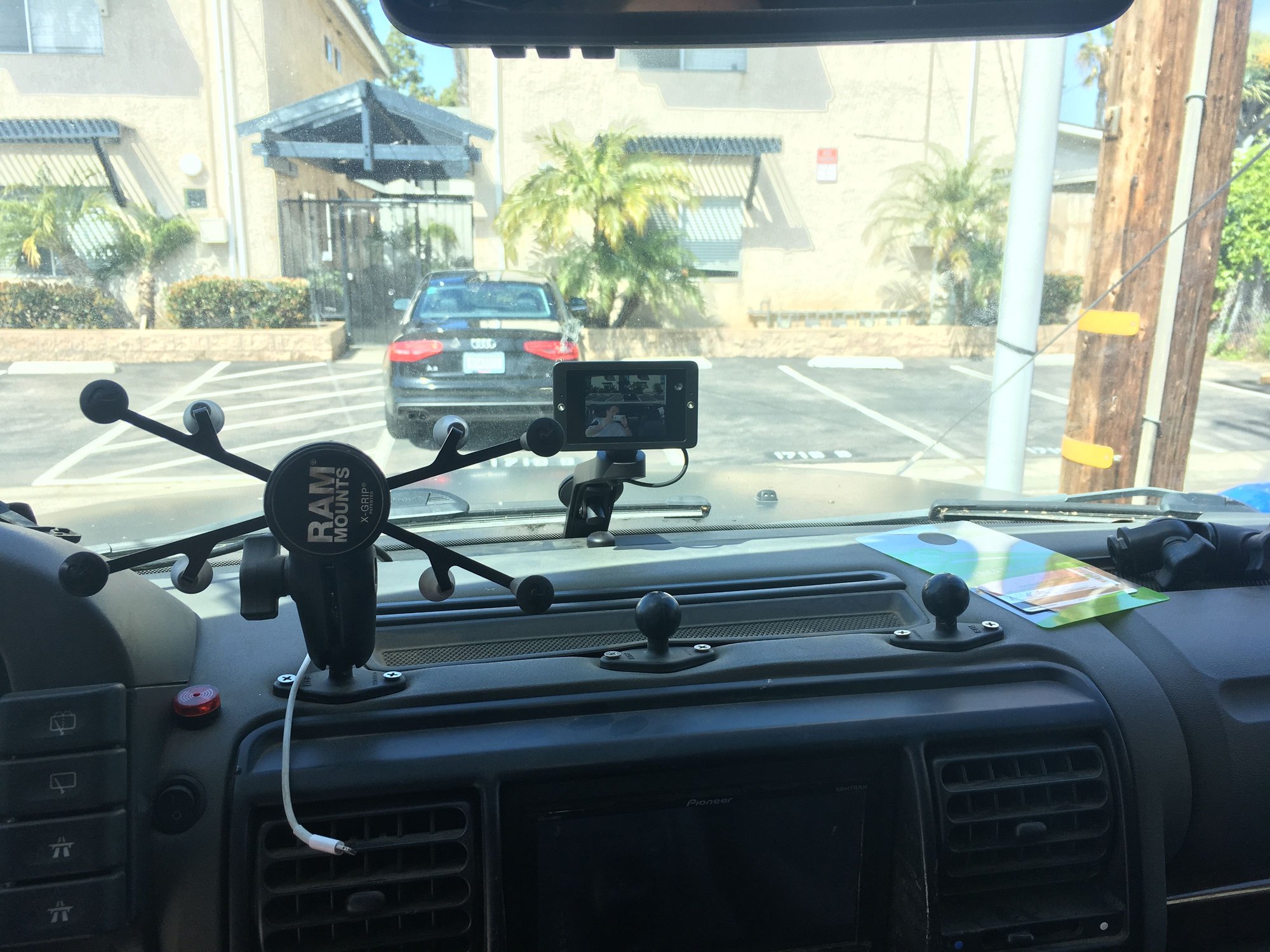

This works well for me

Yes. I have the RAM mount that bolts to an existing seat bolt (see below). I don’t believe it would be a good choice for off reading mainly because of the length of the pole. It tends to move even though it is very secure. For highway travel it meets my needs but any bumping and such would be hard to focus on the screen because of movement. I would go with a dash mount or a mount that is shorter in length to prevent the vibration and movement associated with a longer pole (mount).

Guys, thanks for the pics and the advice!
