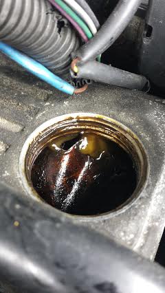

Stayed with some friends for about 2 hours. Started the engine, 02 codes, pending 300,304. Smoke. Its 56* or there abouts. This is what I see coming out of the tailpipe. I cannot smell anything except for rich eye burning exhaust. I did find this under the Oil filler neck as well.
little video of the smoke. You can hear me trying to get a good sniff..
Attached Thumbnails Its developed a thirst for coolant.  Again.-lr-d2-crud-rocker-cover.jpg

If you're intermittently getting a misfire on #4 WITH coolant loss, your head gasket is more than likely leaking into that cylinder. I am guessing that the block is not cracked because it would overheat very quickly. What was the cause for the head gasket failure? What were the symptoms when the gasket, or gaskets, went bad?
Old May 23, 2015 | 03:28 PM
zeroone's Avatar
Joined: Jan 2014
Posts: 579
Likes: 8
It wasn't actually a headgasket failure. I bought a full top end gasket kit due to extreme coolant loss. Turned out the lower intake manifold gaskets where completely gone. I replaced the HG purely because I had the engine torn down that far. When I did the repair I went into it thinking I lost the HGs. It has yet to overheat. I'd love for it to be as simple as a headgasket failure. I really would.
