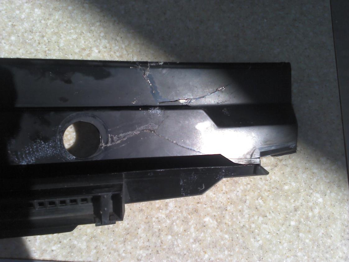

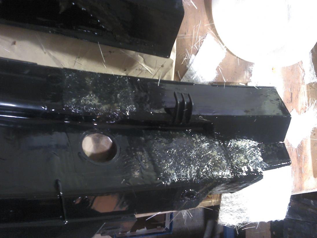

here is my jbweld plus project of the moment.
front window finisher broke into a bunch of pieces. i glued and fiberglassed with slight redesign.

there's the fiberglass bit:
