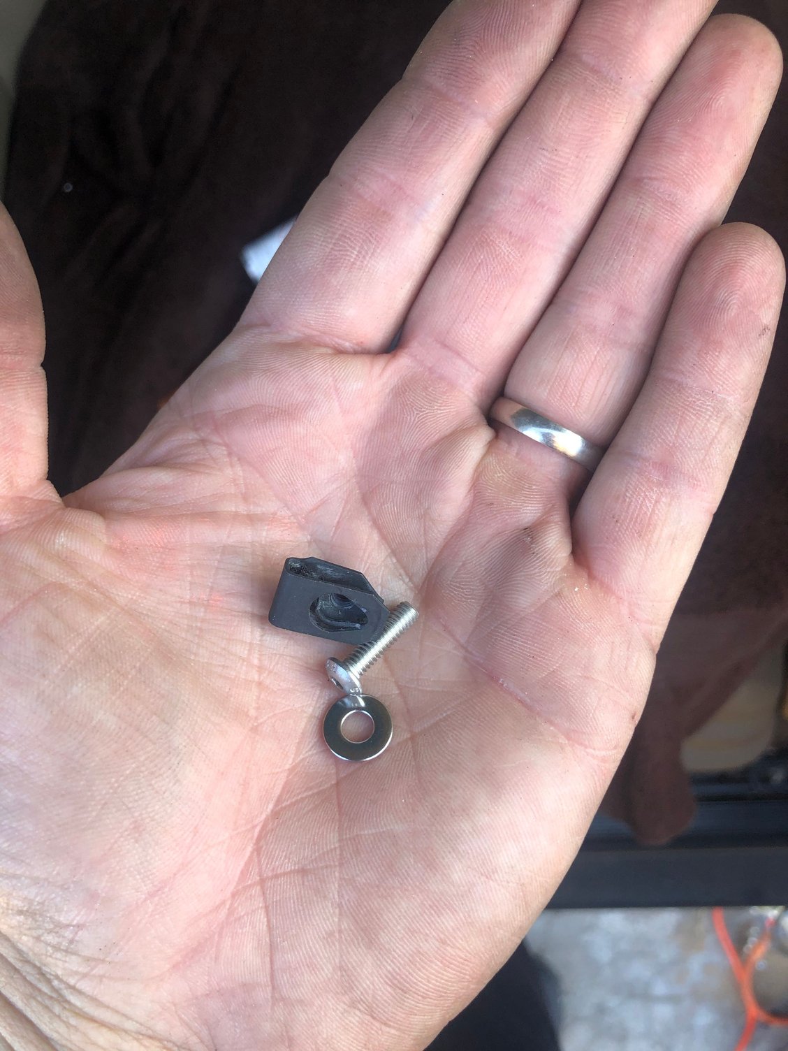

- Rather than fuss with rivets to replace the transmission tunnel plate, use these things in the photo below. Much easier and now you can access it anytime without drilling out rivets.
