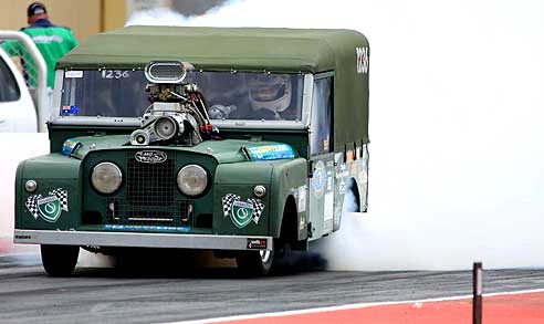

"Power" and "Rover" are mutually exclusive terms. This pix was taken before lug bolts sheared off and took it into the wall.
