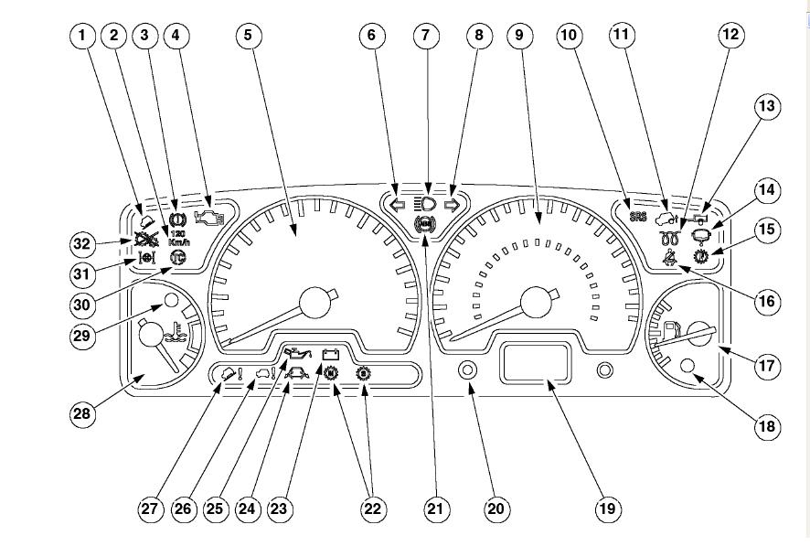

bump for an old thread. I too have been recently been getting a single amigo with the hill descent simbol turning on. I've never had the 3 amigos. ABS and TC work fine. I tried searching for this, but no definitive answer came up.
I'm thinking a short or sensor issue, but don't know where to start looking.
PS: The Hill Descent button is not pressed. When I press the button a different light lights up on the dash. The one that lights up for me now is in the lower left. In the diagram below, light #27 is the one that is lit, not light #1 which lights up when I press the button
