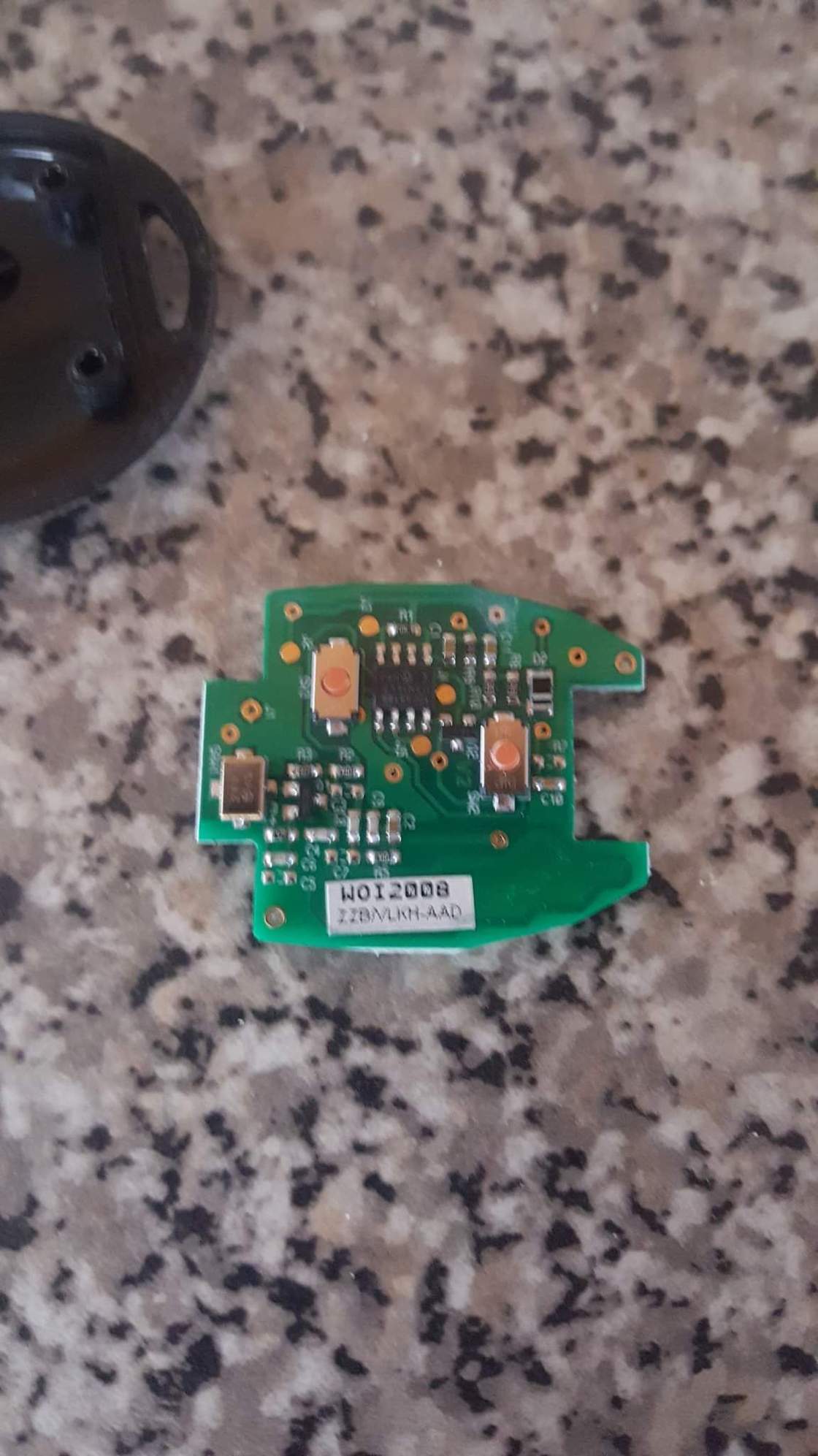

I’m gonna say that one won’t work. My ‘04 came with a “brand new” (which it was) China knock off. Tried with my Nanocom. Nope. I got all the codes and numbers I could from the chip and tried all of them. I posted to failbook groups and just did a bunch of research on it, and it seems the only ones that will work are the OEM ones.
This is what mine looks like:
So I’ve decided to now prioritize when I’ll get keyless entry and pay the ~$300 for a new OEM fob.
