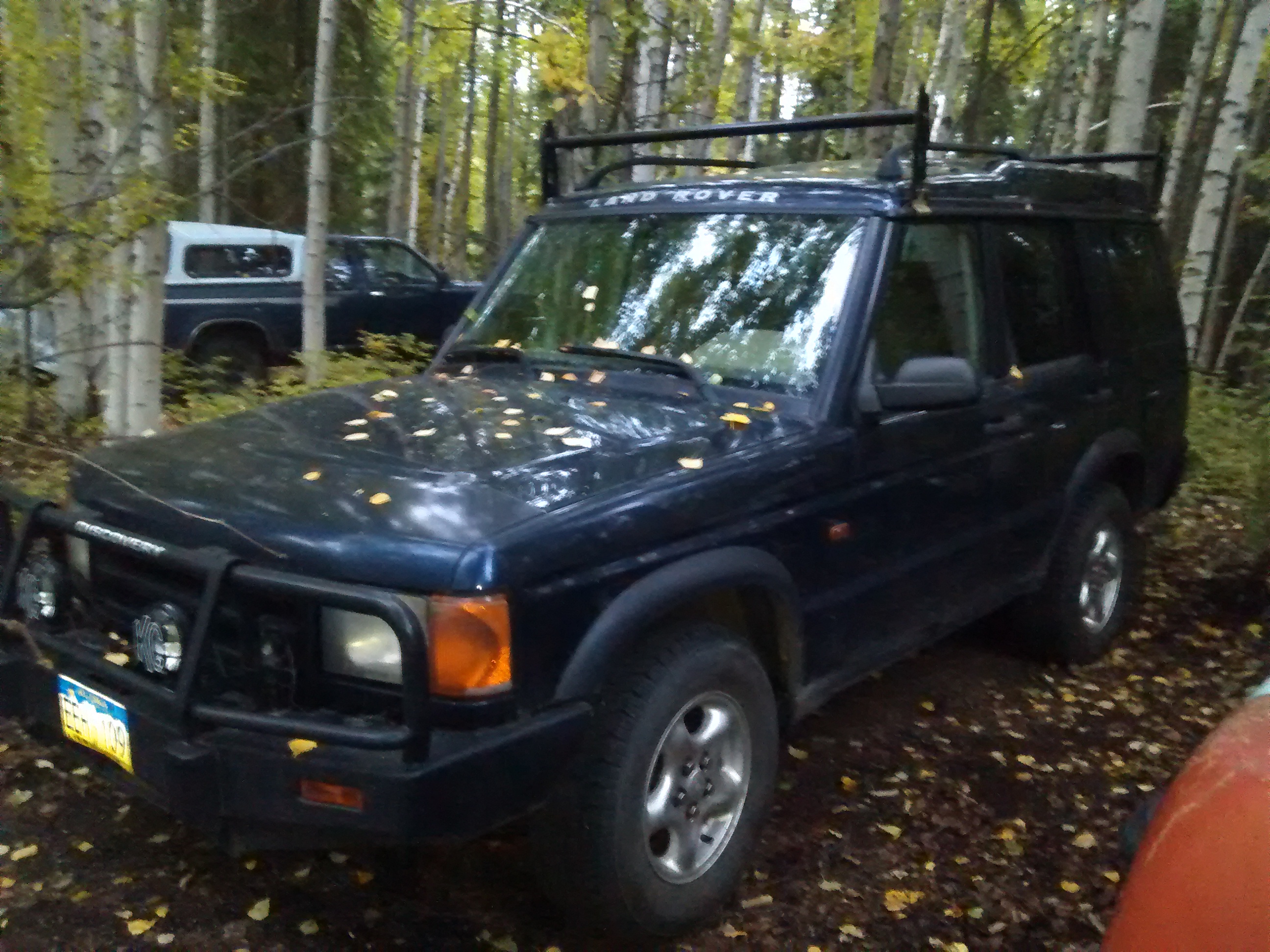

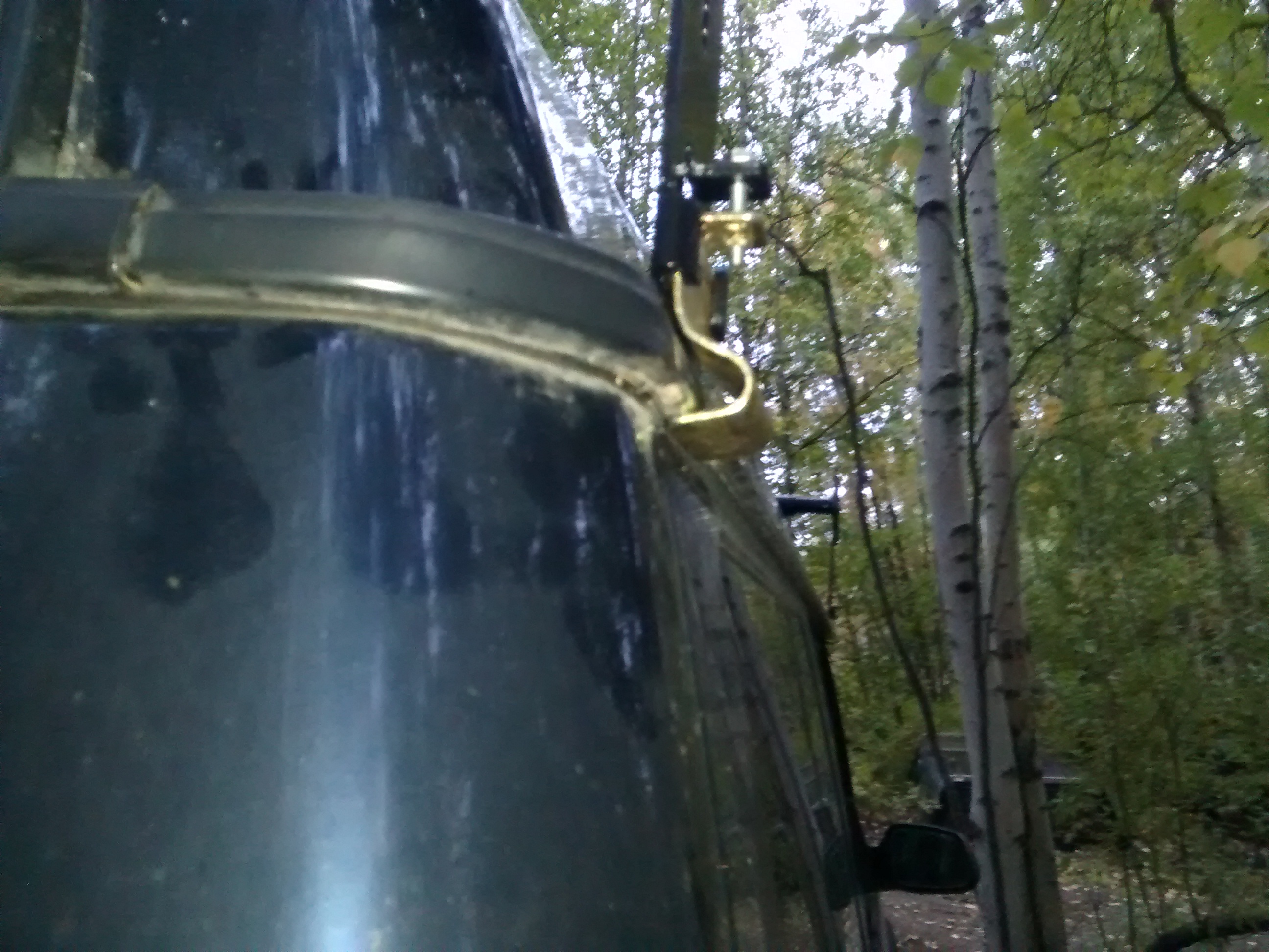

I put my racks on this evening. Things went pretty well. I did have a little trouble with the passenger side rear corner, there was not much clearance under the rain gutter for the bottom of the clamp. I bent the clamp a little and then it worked. The bend I did was where I had straightened the clamp, I just increased the angle a little bit. The driver's side had plenty of room under the gutter, a little difference in placement of the quarter panel I would guess. The racks feel very sturdy. I put them as far apart as I could while staying in the straight part of the gutter, I got 82.25 inches on the bars, center to center. There is about 1 inch of clearance over the rear of the roof, and if I had put the front bar over the factory roof rails I would have about 1 inch. Other than my less than stellar paint job I think it looks fairly good. I originally was planning on just 2 bars to carry a canoe, I am now thinking about putting one or two more racks on it and building either a platform, or a basket to clamp on it.
