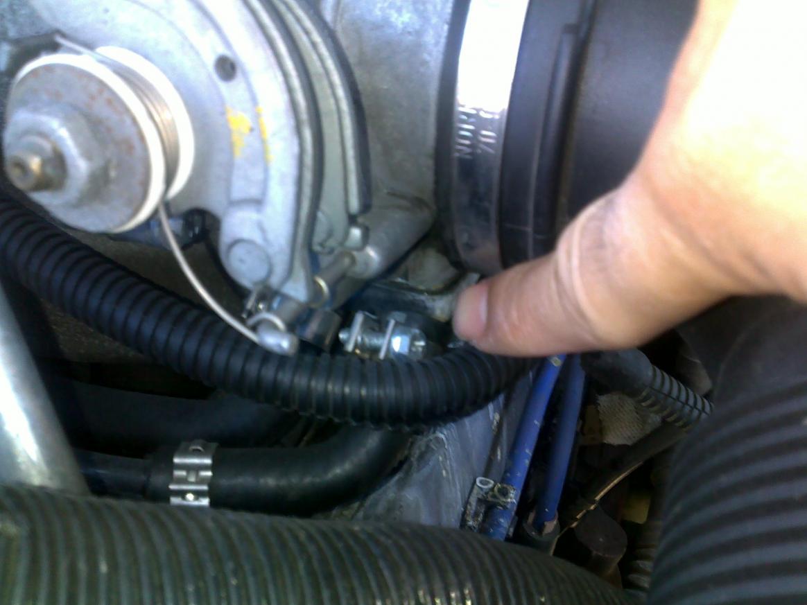

Hello guys, it seems like im leaking coolant at this area from the pic. how do i stop it? is it a gasket? what is it called and where can i buy it?
Edit: by the way. its no the 2 hose. my step dad said that gasket needs to be replaced?

Start reading all the posts on this or any other Rover forum about leaking t/body heater plates.

X2 throttle body heater plate...at least you're not running Dexcool.
Here's a fix....or you can bypass it like some folks do.
https://landroverforums.com/forum/sh...954#post153954

You can buy the kit on line but I would suggest you buy it from a dealer as a set cause it has been mentioned on the LRO that there is another up-dated kit now available, but for now it is safe to say it will be dealer only.
