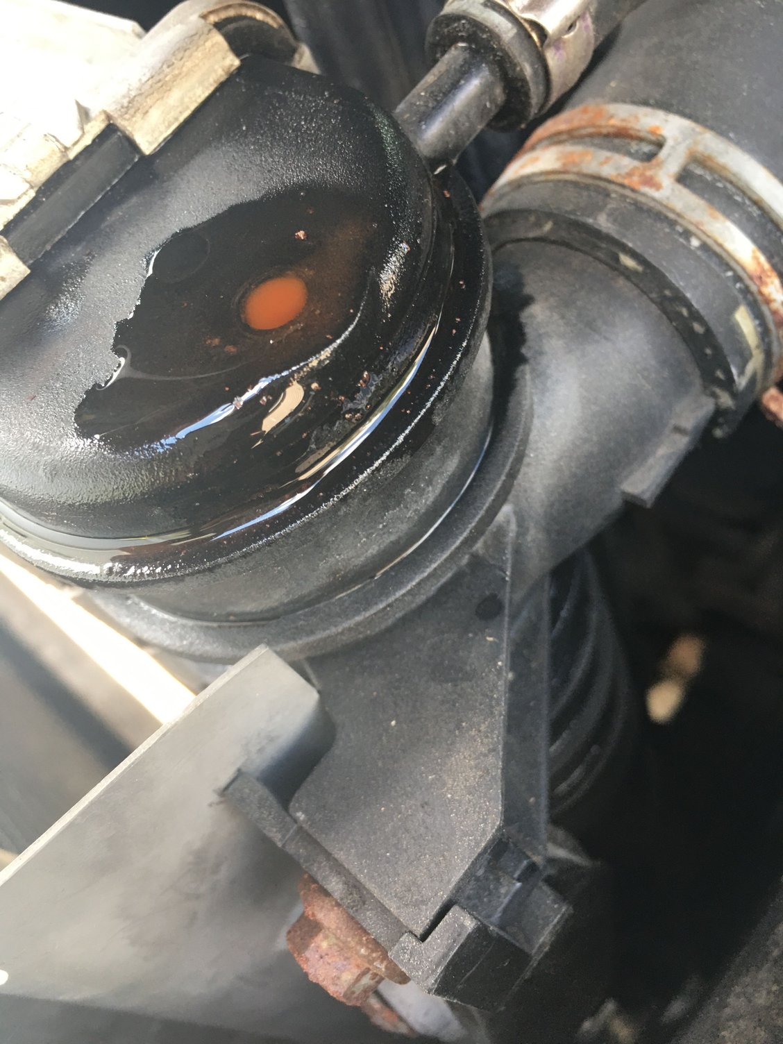

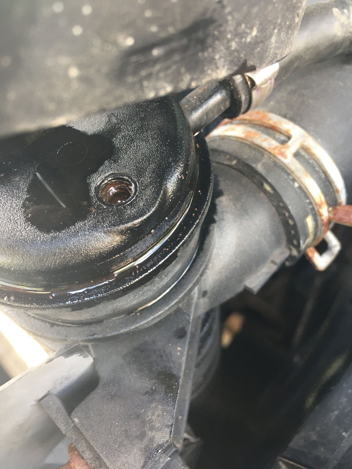

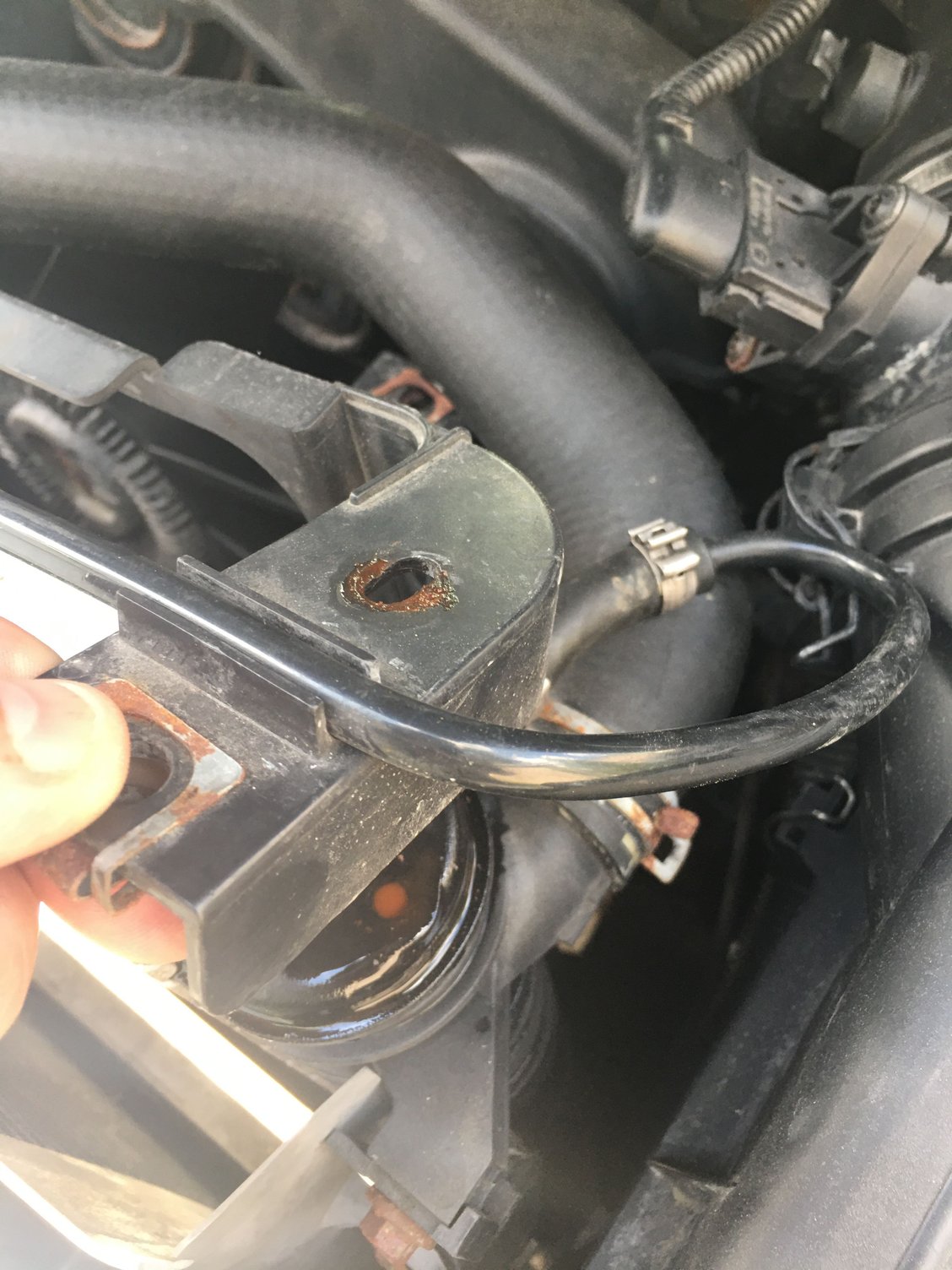

Now that I got the car unlocked the reason why the battery went dead is I had a leaking radiator and wasn’t driving it. Let it rain and heat up for a few minutes and this is what I found.
The screw was rusted although intact. Not sure if it’s perforated the radiator or not the other side look fine

Typical spot to leak as they crack from the screw over time.
new radiator time

Cheap eBay rads have a good rep around here super cheap.
Just remember when putting that screw back in cut a bit of the tip so it’s not that long

Yep cut off like 1/8 of an inch & never have that problem again.

As long as you remember to put that same short screw back in the same hole the next time...

I usually add a couple flat washers to those screws, helps add a bit of stability to the shroud cover also.

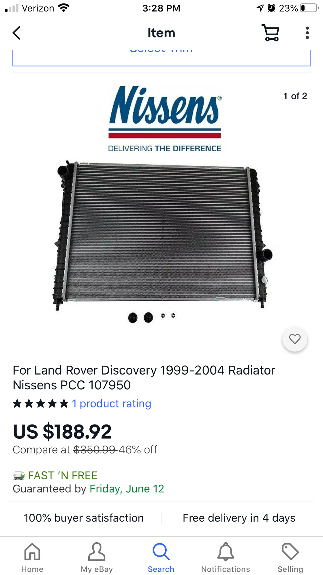

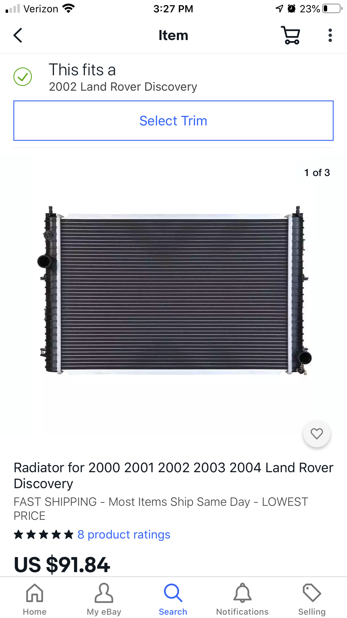

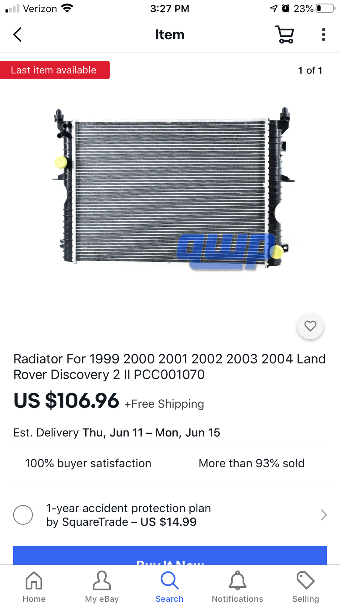

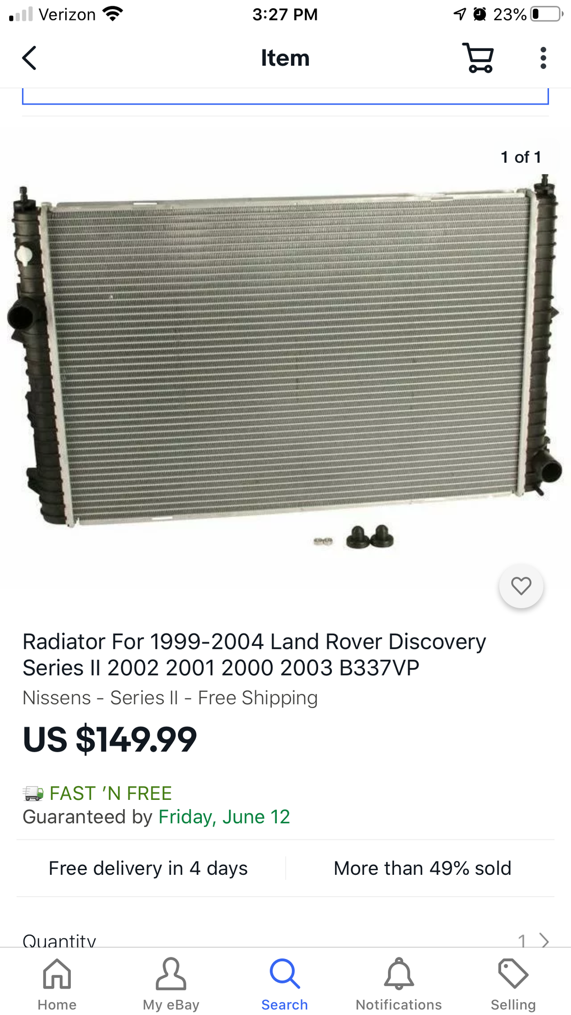

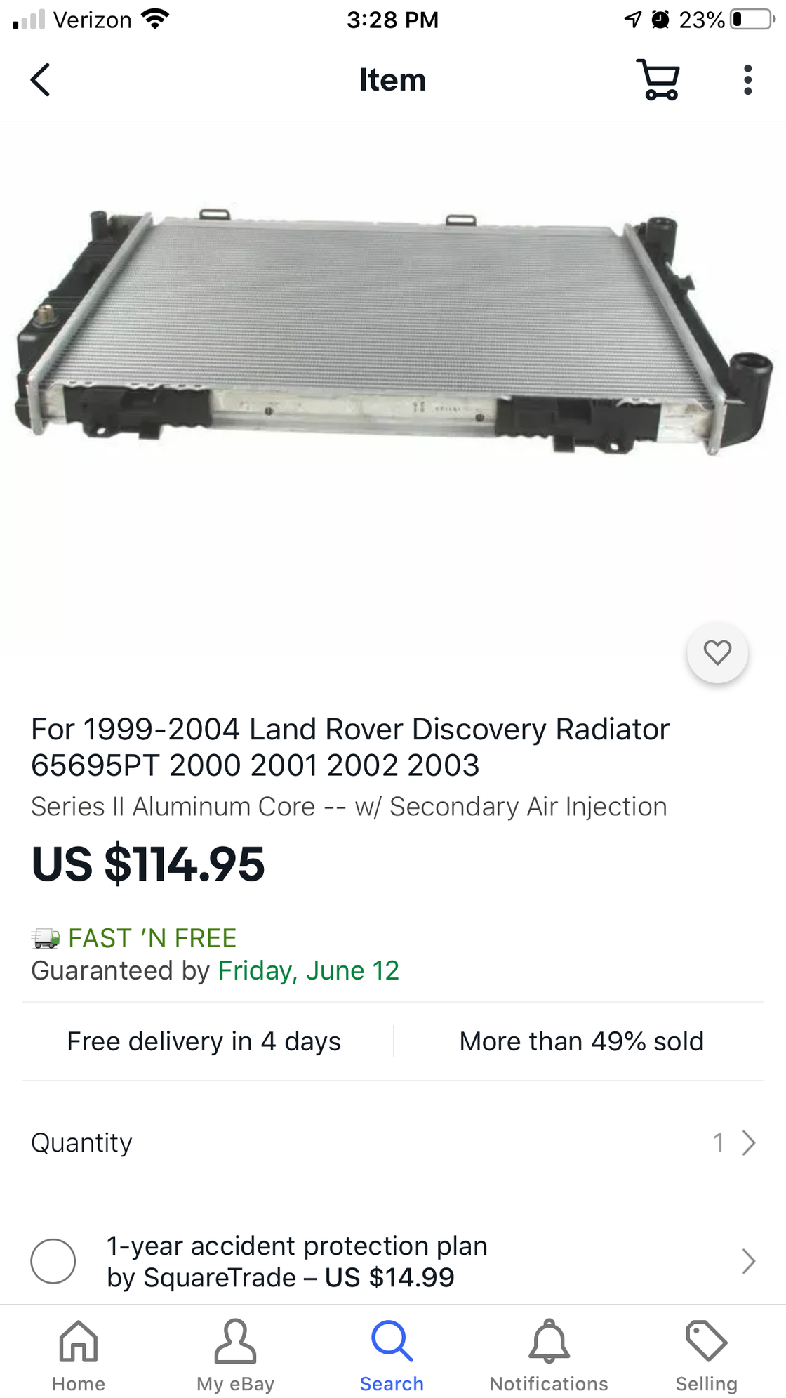

Default Now which e bay radiator to get
