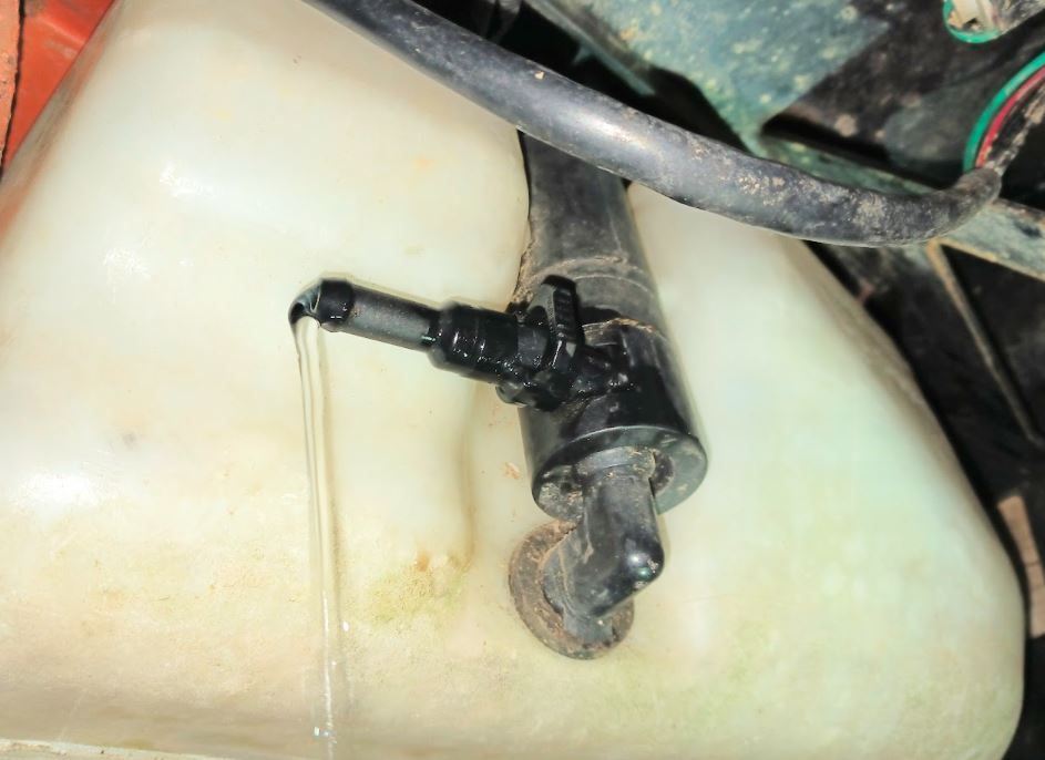

This washer hose clip is connected to my washer reservoir and it's dripping washer fluid. I'm not sure the clip is bad but I've never seen this type of connection. How is it supposed to work? The hose connected to this clip looks fine and doesn't leak, just this little clip. Any help is appreciated.

Looking at your pic. First -- you have to tighten the clip (it ratchets down on itself - just squeeze it) -- and there should be a hose connected to the end of that nipple. IE - you're missing the hose that the clip is supposed to be clipping on.
