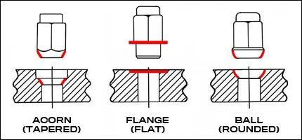

This should help clear things up..
Lug centric lugs are either tapered or are rounded -- depends on the wheel you are working with. Hub centric use flat lugs. HOWEVER, most wheels these days don't use flat lugs, at least on the cars i've seen/worked on/owned.
I had a set of hub centric wheels that i ran on my 85' Vw Golf for a day without the hub centric ring (had to get them custom made) and any thing above 60mph, i got the shakes. This could lead to all sorts of problems down the road including the wheel coming off while at speed which is a no bueno situation.
I would rather squirt lemon juice in my eye then drive a car that didn't have a proper hub centric wheel / lug setup.

Well kinda like you, never ever have I seen a hubcentric wheel that also didn't have conical lugs. Never in my lifetime have I seen a flat lug nut. Weird. Oh yeah, I'm 62, Haa.

You must already have non-stock wheels, because stock lug nuts are flat lugs.
