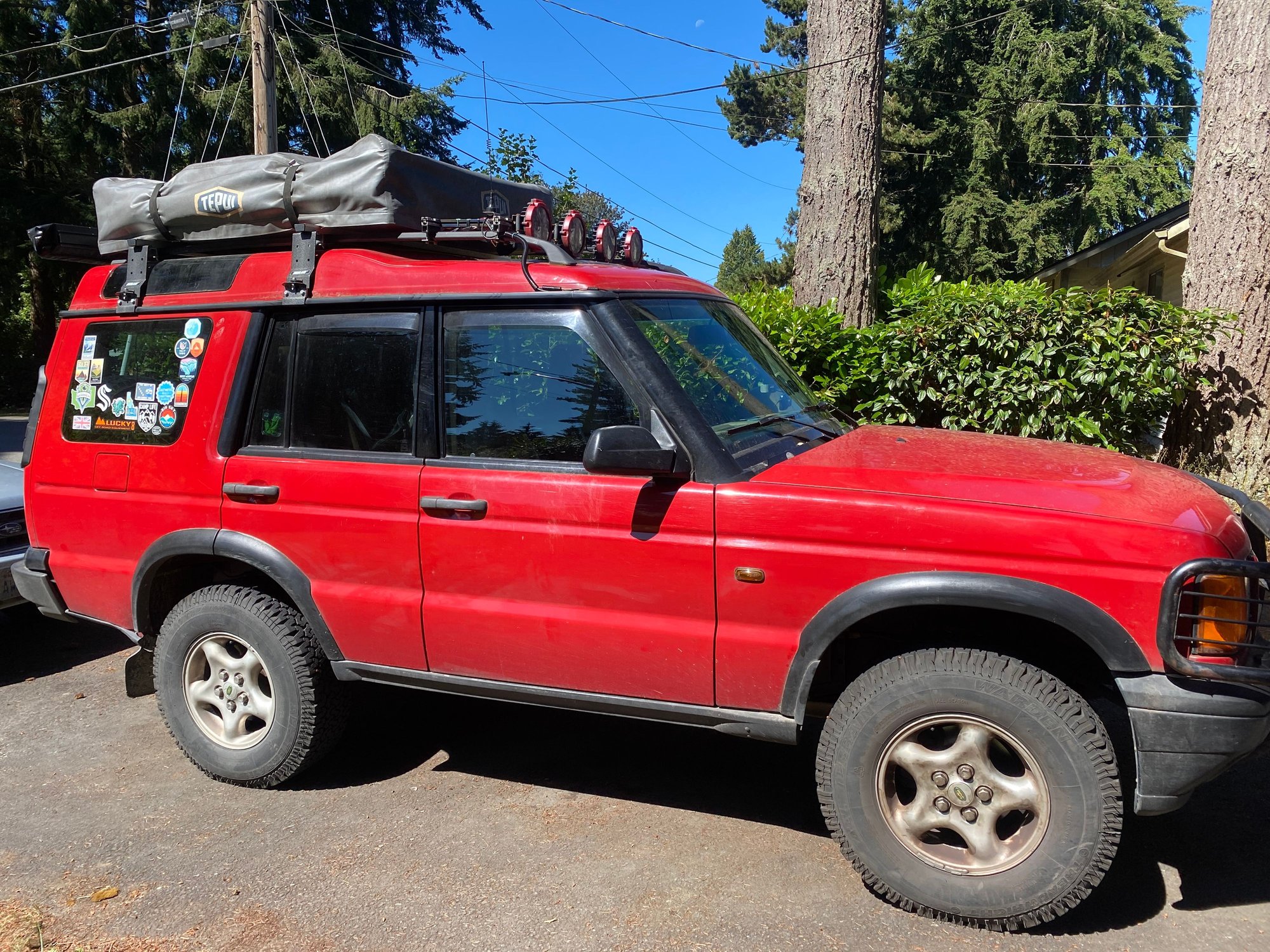

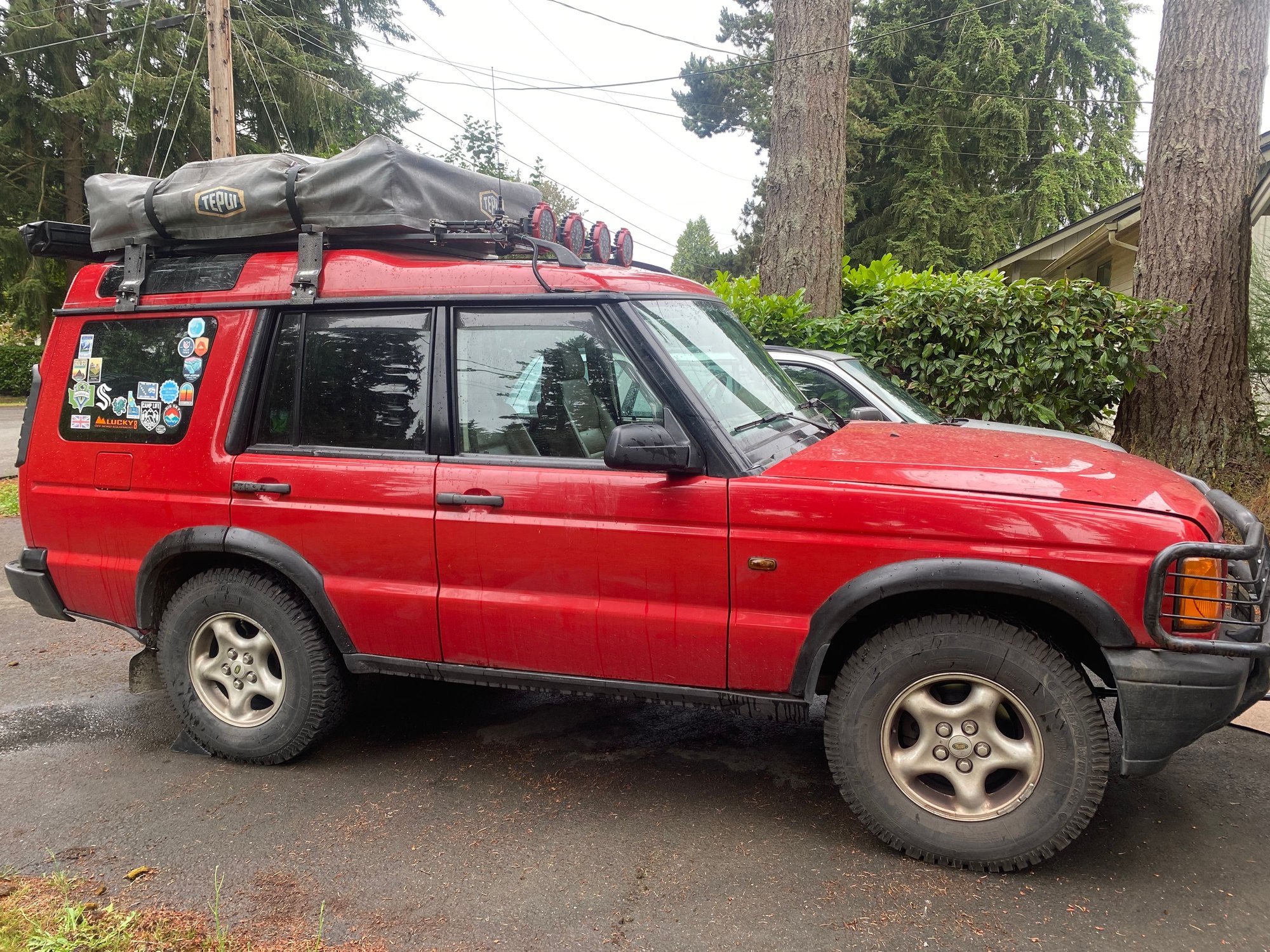

After having the parts for months I finally got around to putting my 2” TF lift kit on. I used D1 spring perches for n the back so technically it’s 2.5” in the back but I usually have the back loaded up so I think it’s going to help a lot keeping things level. Some thoughts:
1) One of the front shock tower nuts was seized so I was unable to remove the tower so I had to get real creative with some zip ties to compress the shock as far as it would go before it could squeeze in.
2) I had to use a spring compressor even though I tried to use the “bottle jack method” to get enough clearance, I just couldn’t make it work. Thankfully I had to compress the springs just a little bit.
3) I had never worked on any suspension before so I was nervous going in but the job wasn’t bad at all, there are so many good resources in this forum and out on YouTube that I would encourage anyone to undertake the job.
Before and after pics:
Before pic
After pic
