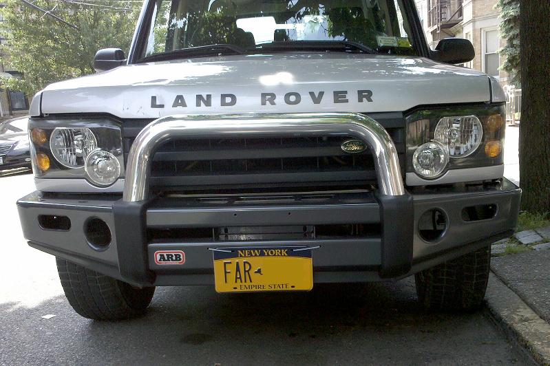

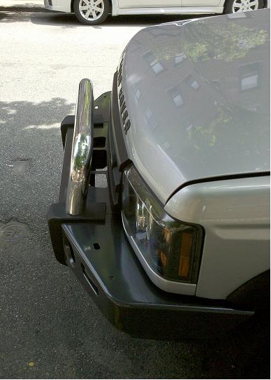

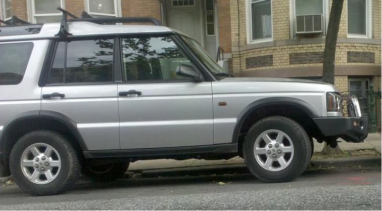

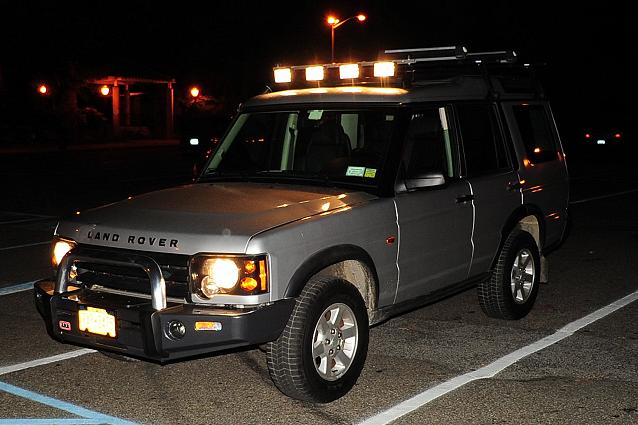

here are some pics of how the Sahara looks mounted on my truck...
some of these were taken before it was complitely installed but you can tell what a monster it is...
good luck with your upgrades

i was thinking long and hard before i went with the sahara. i see you went with the deluxe ARB, i saw it mounted on a truck here in a dealership and thought it was to much steel for a truck that will be mostly driving in the streets of NYC, the only difference between the deluxe and sahara seems to be the crome tube vs the whole front of the truck being protected...
its quite a bumper thou... 2 weeks ago doing 60 on a highway, the cab in front of me just slamend on the breaks.....all i was thinking was "F*** my bumper will be end up on his back seat", never did i worry i would get hurt...ha ha. was able to stop a few inches from his trunk....
my point is... the advertisemnt pics can sometime cost ya more money that you had thought..... its about 300$ to get that bumper painted to match the truck, but then it looks freaking awsome......
