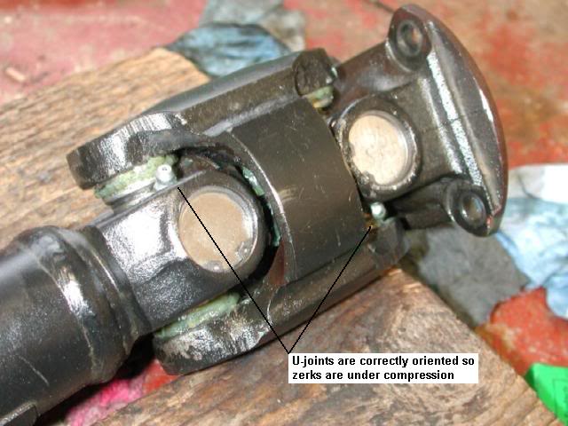

Hope they went with an upgraded shaft, instead of original design. From the factory the propshaft did not have the extra grease fittings that aftermarket shafts have. So after a period of operation it will be subject to same failures as before. But, $900 is less than $900 + transmission, which is what a snapped shaft can take out before you can get to the side of the road. Pix of the trouble areas for the shaft.
