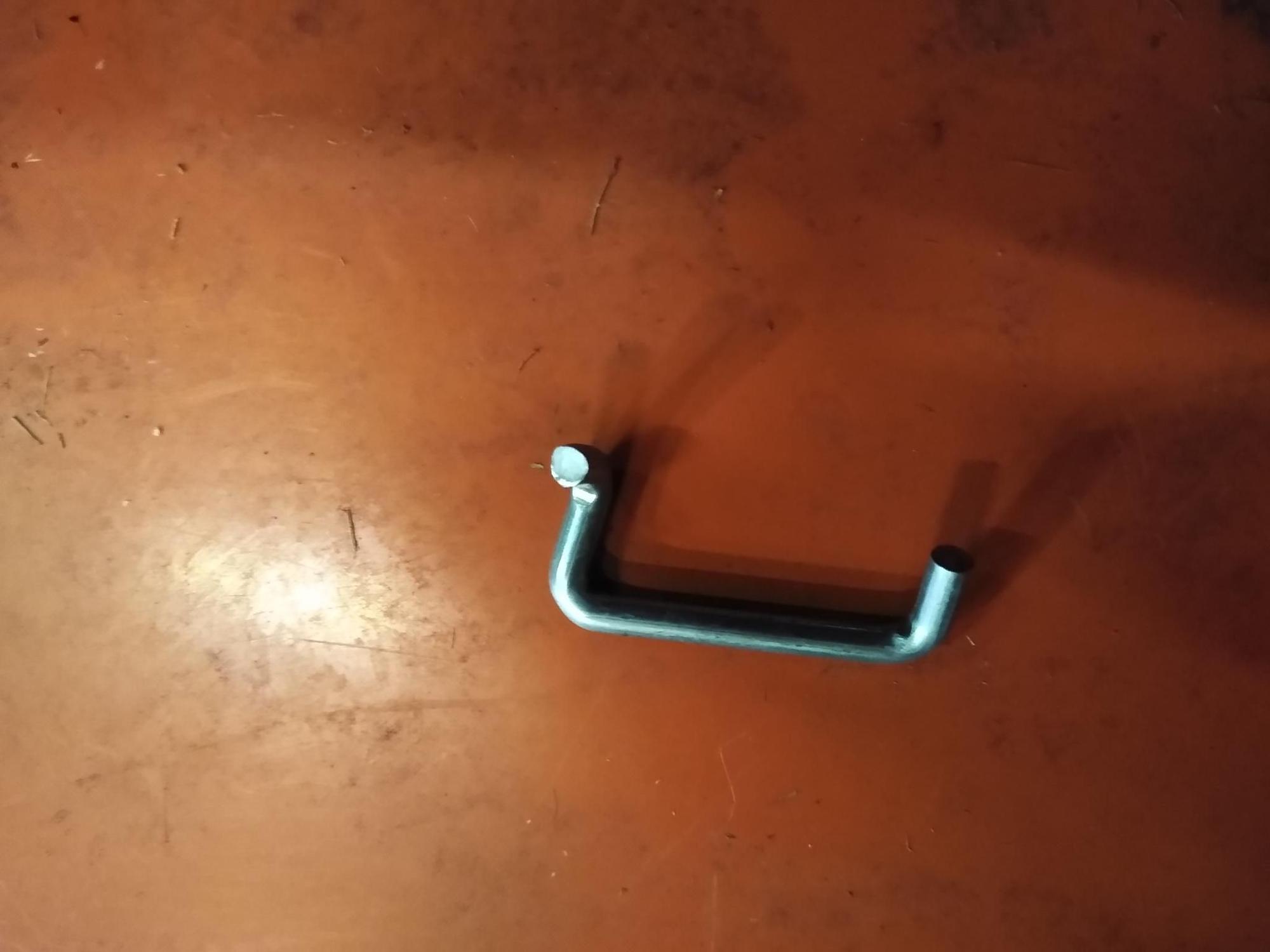

The rear passenger door to my 2002 Discovery II is closed and will not unlock/open. I can pull up the unlock tab manually and I hear normal "clunk" of the mechanism unlocking, but the door will not unlock. I can also electronically unlock with the pull tab going up and down, but still will not open. The door panel is off.
I know this part is not attached::
This is a pic of a replacement part that a friend dropped into the bottom of the door and it not been installed, yet. What is the best course of action to get the door open? Saw through the locking catch on the side of the door opening and get a replacement actuator? Another trick? Ideas/thoughts?
Thanks for the help!

I confirmed the child safety lock lever is in the unlock position. I pulled the inside door handle and then tried to pull the cable forward with small needle nose pliers and there as zero give and the door remains shut. I can feel the cable move slightly as a pull the handle at the other end of the actuator and It seems like is working (the cable) as it should.
Maybe the rod (pic in the original post) needs to be installed and maybe I can open it from the outside, maybe? Thoughts?
Is there a schematic for how the rod is installed? I didn't take it out when it got dropped into the belly of the door. Is there a trick for installing it? Tips?
