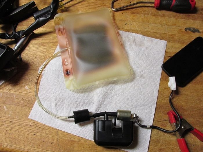

here is what the bladder looks like. the pump is in a black pouch in the seat back. Pump is in the black plastic case, release solenoid is the silver barrel. The white plugs are inside the seat and connect to sea controls via the grey plug. You can test the pins directly on the grey plug. refer to RAVE for pin diagram. Careful removing seat cover. There are 2 and sometimes 4 metal 'U' clips holding the cover to the bottom of frame. The plastic 'J' hook (long black plastic hooks) break really easily......
