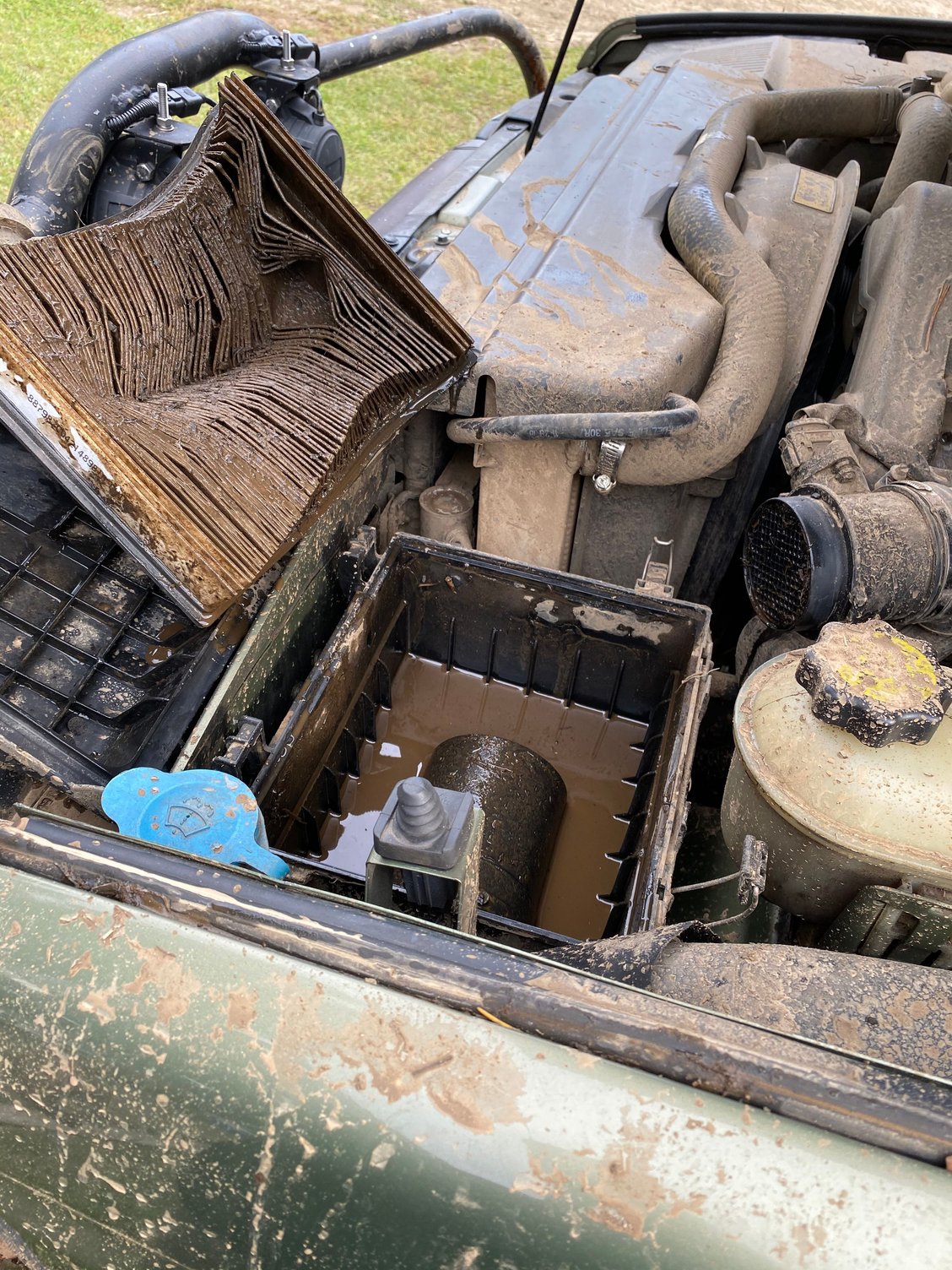

I want a snorkel for water. I destroyed my maf when this happened, thank god I didn’t hydro lock my motor.
I prefer the old school snorkel look of the round air filter on a metal pipe over the plastic arb style as well. I will probably fab up my own and try to find a round filter assembly
I've done this twice now and I have a snorkel. Really I've this twice because of the snorkel. We live in an area where roads and fields can flood in heavy rain periods. Roads get closed and it's really a fun time to go Rover'around But I have a habit of bombing into water and the spray coming up from the front wheel goes right at the snorkel. Anyways, I've learned my lesson and turn my snorkel around (I have an ARB style one) and slow down when entering water. I'm also pretty good at changing MAF sensors, mopping out the airbox, draining water from the intake resonator deal (has a plug in the bottom of it now to make it easier to drain), and keeping some towels or rags in the D2 just in case I do this a 3rd time.
