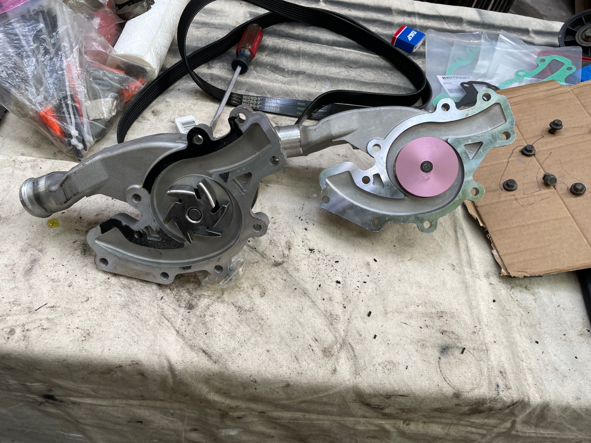

service manuals in the google drive. have at it
Thumbs up for Flowkooler

Thanks again everyone. Finally got the Flowkooler installed today and sure enough, no more leaks. I downloaded the Rave manual finally, thank you WaltNYC!
Now I’m just waiting for the new hoses & in-line thermostat to arrive & I’ll get it back on the road. Really appreciate all the help!
