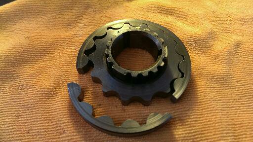

Looks like mine when I took it in to get the oil pump replaced due to low oil pressure.
Indy Rover tech said he's seen it a million times on Discovery's.

drowssap's Avatar
Posts: 9,298
Likes: 318
From: Boston Strong
unfortunately it is, only 2 pieces your lucky I have seen them broke in as many as 5 pieces.
