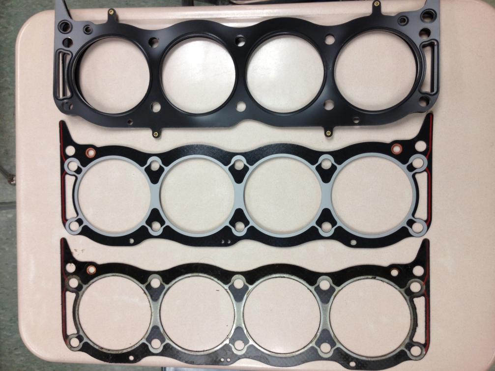

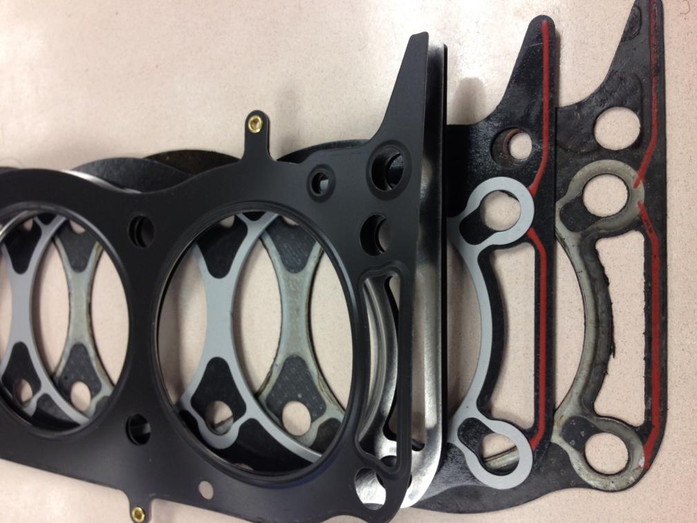

Informal head gasket comparison:
What looks to be a used OE headgasket (at 96K miles, who knows... could have been replaced already) -used.
The middle one is a no-name (supposed to be Victor Reinz, but I doubt it) -new.
The last one is the famed Cometic multilayer steel (MLS) HG.
I measured the thickness of the gaskets in two areas, first being the fire ring and second being the composite material -or on the MLS, the compressed edge. Furthermore, I also measured the used HG in an area not compressed by the head/block -just for an idea of how thick the composite material may have been prior to use.
I'm using a Fowler 0-1" 0.00005" digital micrometer, but rounding to 3 decimal places.
Measurements respectively:
Used HG:
.048" -fire ring between cylinders
.053" -composite crushed
.058" -composite non-crushed
No-name HG:
.074" -fire ring between cylinders
.061" -composite
Cometic .040" MLS HG:
.056" -raised portion of fire ring
.040" -flat area that would be comparable to area measured on composite hg.
Interesting to note that the openings for the cylinders are smaller on the MLS HG in comparison to both the composite headgaskets:
Composite: 96.08mm (3.7525")
vs
MLS 94.21mm (3.7085")
This may help seal the cylinders better by actually providing material for the liner to interact with.
That's all for now...

"Interesting to note that the openings for the cylinders are smaller on the MLS HG in comparison to both the composite headgaskets:
vs
This may help seal the cylinders better by actually providing material for the liner to interact with."
____________________________
I am sure it does; that is a very good thing. Thanks for the data

The Cometic HG's come in 96mm and 94mm bore sizing for the Rover's. I looked in RAVE and 94mm is the listed bore so that's what I ordered.
Wonder why the OE headgaskets come with the 96mm bores?
