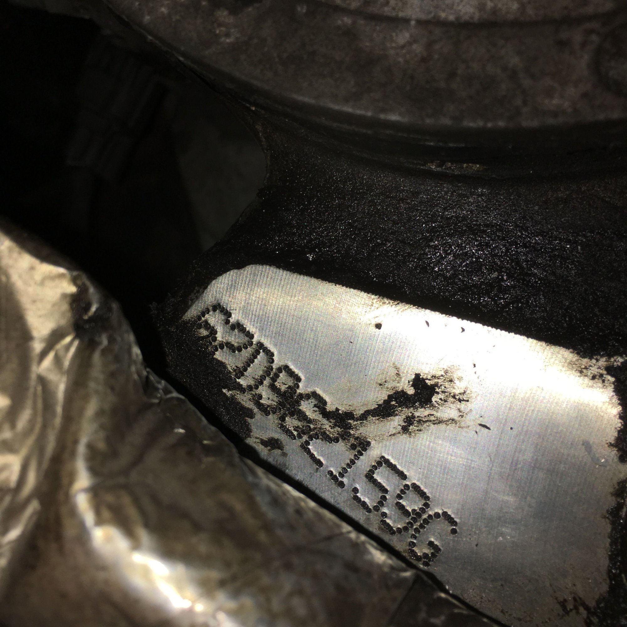

I have the Microcat information. It says my 2002 has a Transfer Box Ratio 1210 (107AB). How do you find the 41D or 42D prefix to see if you have the CLD upgrade possibility?

Had to lay down under the vehicle (2000 Disco II, built 8/2001), and I found the serial number. 62D, no diff lock.

Exacty where was this? Tx

Circled on the photo I included. Bring a damp rag to get the dirt off.

Thank you for taking the time to post that! I'm going in!
