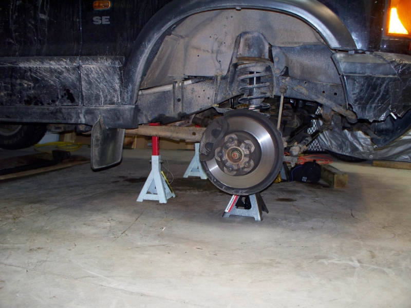

I finally got all the parts and had some time over the weekend to pull the pan.
To maneuver the pan out, I removed the crossmember, then took the front wheels off. I then put jack stands underneath the frame but where the cross member brackets are welded on, then lowered the front axle (with the additional clearance removing the wheels gave me).

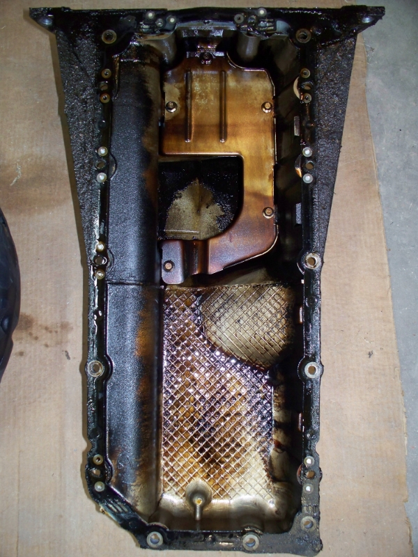

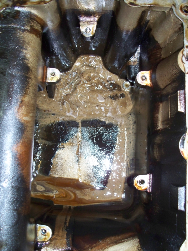

Once I got the oil pan out, I removed the plate inside the pan. Lots of sludge.

Right now the pan is soaking in Blue Dawn (the kind they use to clean penguins after oil spills) with a thorough rinsing and power-washing to follow.

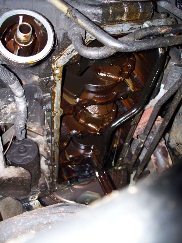

I had a couple drips of coolant from the front side of the engine. Below you can actually see a drip of DexCool forming on the end of where the oil filter screws on. You can also see that the underside of the timing cover is fairly wet.

That's really not that bad. That looks more like condensation emulsification from the oil temperature never reaching waters boiling point. Remember that oil is extremely hydrophobic in most cases. The composition of coolants in general allow water to mix freely with oil.

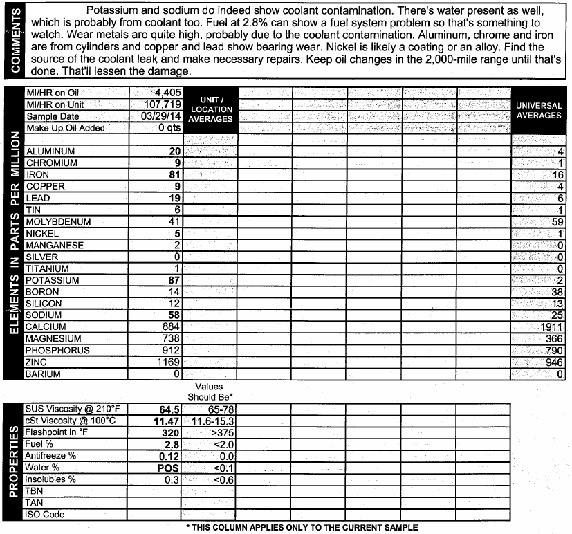

I thought as well that it was just emulsification (and was hoping it was). But to be sure, I sent a sample of my oil in to Blackstone Labs for analysis just to be sure I actually did have coolant in the oil instead of straight water. According to the analysis they saw evidence of potassium and sodium as well as water along with higher than usual aluminium, chrome, iron, copper, and lead that they attributed to higher than normal wear levels on the bearings and cylinders.
What do you make of my hot block pressure test results losing 2ish psi every 10 minutes, vs my cold block pressure test losing about 1-2 psi over 12 hours? I'm not really sure how to interpret the difference in pressure loss (other than that a leak exists).

That analysis is total snake oil. There are so many variables that make that test useless. on the other hand, the potassium finding is coolant. BUT the coolant % is estimated to be .12
So like your oil is 99.88% oil. That's pretty good right there. you have a low flashpoint, which is directly related to fuel absorption. Could again be directly related to the oil temp never reaching a high enough temperature. Or excessive cold starts. (IE back car out of driveway, move wifes car out, restart truck pull back in driveway, run to 7-11 2 mins away run back home, all really bad for oil.)
The hot pressure test is unreliable for block testing. the contraction of coolant as the temperature drops ruins the test. In a perfect world you should be able to pressurize the cooling system to 10 PSI ice cold, run the engine to full operating temp for a 1/2 hour or so and then let the engine return to ice cold and see if you still have 10 LBS.
