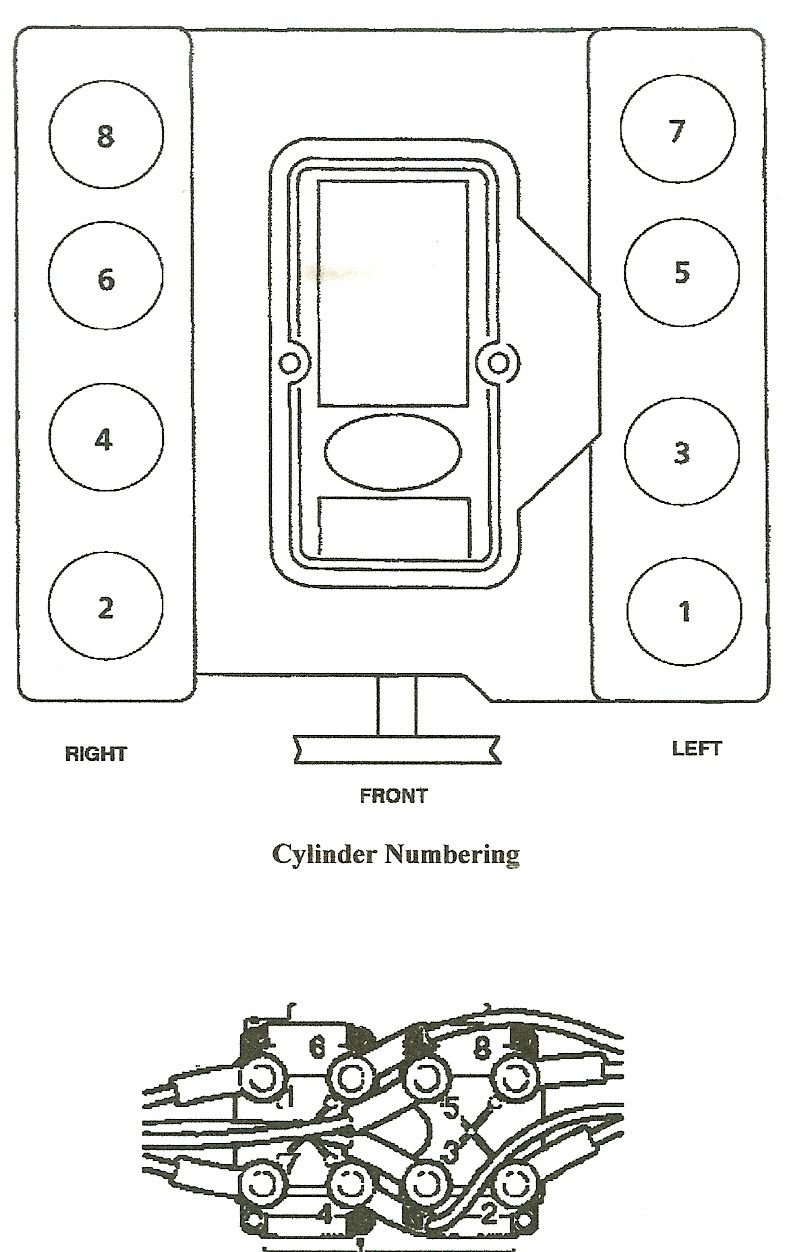

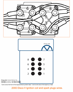

Originally Posted by mr4x4
OK sounds like a good idea. I now know that the coils for the 4.0 and 4.6 are the same but I wounded if the firing order is the same. Maybe two spark wires are crossed.
Nevermind about the firing order being different just check and the 4.0 and 4.6 have the same exact firing order
