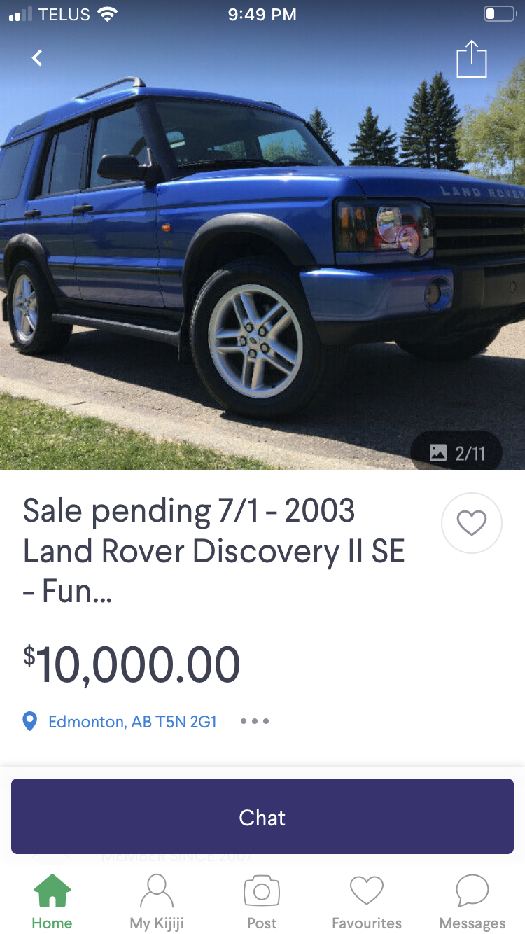

Don’t see the blue ones very often. But this week one came for sale

You don’t see Monte Carlos much at all. I’m not sure if it’s true, but from what I have read, it was the color used on the dealer documentation and was the feature color for the 2003 MY. I know the Icelandic Blue is the color that only 200 were imported to the US. I don’t know how many Monte Carlo’s are around, but its not many.
Monte Carlo looks pretty stellar cleaned up:

That color is Icelandic Blue. Super cool. Only other color I would want. That is a score.
