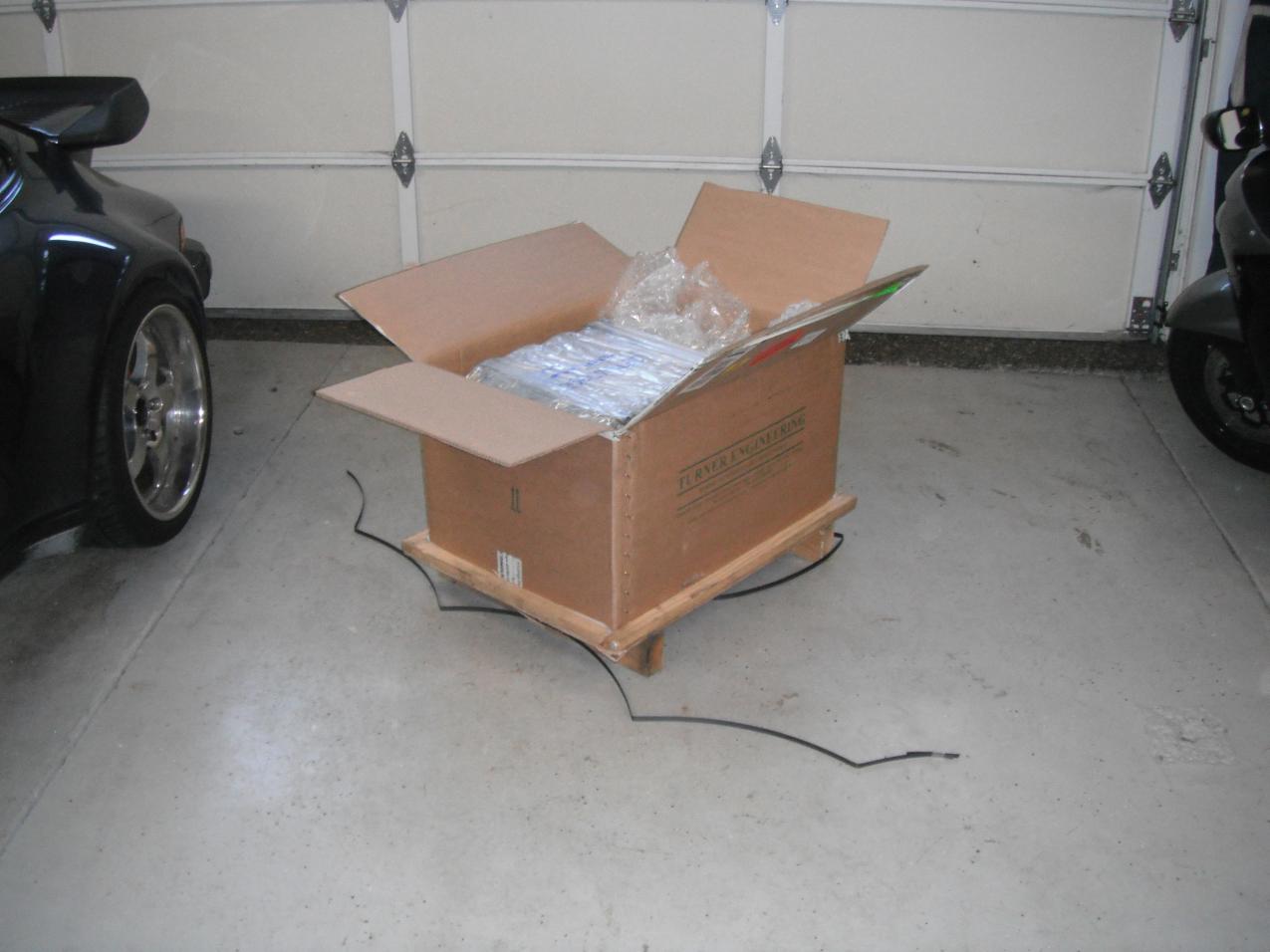

I just did a compete engine replacement in a 04 Disco with 4.6. It appeared that I had a sleeve drop (turned out to not be the case, but that another story). I purchased a rebuild engine from Turner Engineering in the UK. The shipped it to my house in three days from payment. The engine swap is fairly simple and the quality of the rebuild motor is great. I can send some pics of the work if that would help. The whole project with all fluids, new oil and water pumps was about 5K.
As luck would have it I now have an extra set of Air injection heads and a compete short block both with about 73K on them.
Hope this helps
