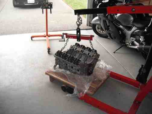

Here are some pictures of the motor swap. The Turner engine was delivered in three days from England to Seattle. It was a fun project even if it was just an academic exercise.
My Disco is an 04 and out of the vin range. The mechanic that diagnosed my slipped sleeve assumed it was the sleeve with out checking the head gasket. A second opinion is always a good idea. Bad move by me!

in the end, if you're happy with what you've done, then great. i'm sure it feels good knowing you've got a reputable company rebuilding a motor for you. shouldn't have to worry for a while now.
