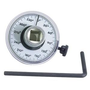

Do you mean just the impact socket to use on the torque wrench? For the 2 90* turns after the initial torque.

Pratice picture
