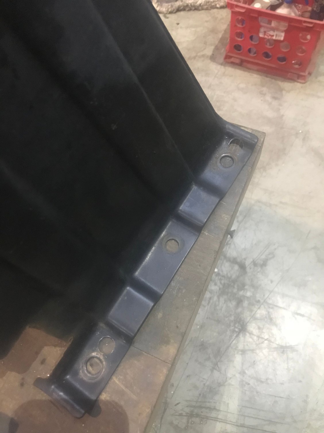

I decided that before I bought or made an adapter to allow mounting the 33” tire that I would see if it was possible to modify the existing mount. It had already been flipped and notched to accept the 32” tires that I was previously running but I needed about another 1/2” for the 33”s. So my mount had been currently flipped and reinstalled with only 4 of the original bolts. The middle bolts on each side are off center and did not line up when flipped. So I moved the mount up so the middle bolts lined up and redrilled the other 4 holes. The upper holes on each side were simple and just required drilling. The lower right did not have enough material for a full hole so it was notched to allow for a bolt. The lower left needed to be drilled in a stamped area so I used a vice to flatten that area. It was actually a simple mod and when completed I had 3/8”+ clearance for the 33” spare. The hard/time consuming part was removing the subs and door panel.

I'm running a 33" spare with mine flipped as well. I only redrilled the middle holes and mine rubs the bumper a little. Good tip on redrilling the other 4.
