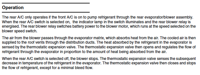

According to the RAVE, "The thermostatic expansion valve ... regulates the flow of refrigerant through the evaporator in proportion to the amount of heat being absorbed from the air." Since the expansion valve is the only thing controlling how well the rear A/C cools it seems to me that the one in your truck may be stuck in a closed position.
If that diagnosis is confirmed replacing the valve will require evacuating the system before removing it and then recharging the system after the replacement valve is installed. That's work best left to a pro with the correct equipment.
