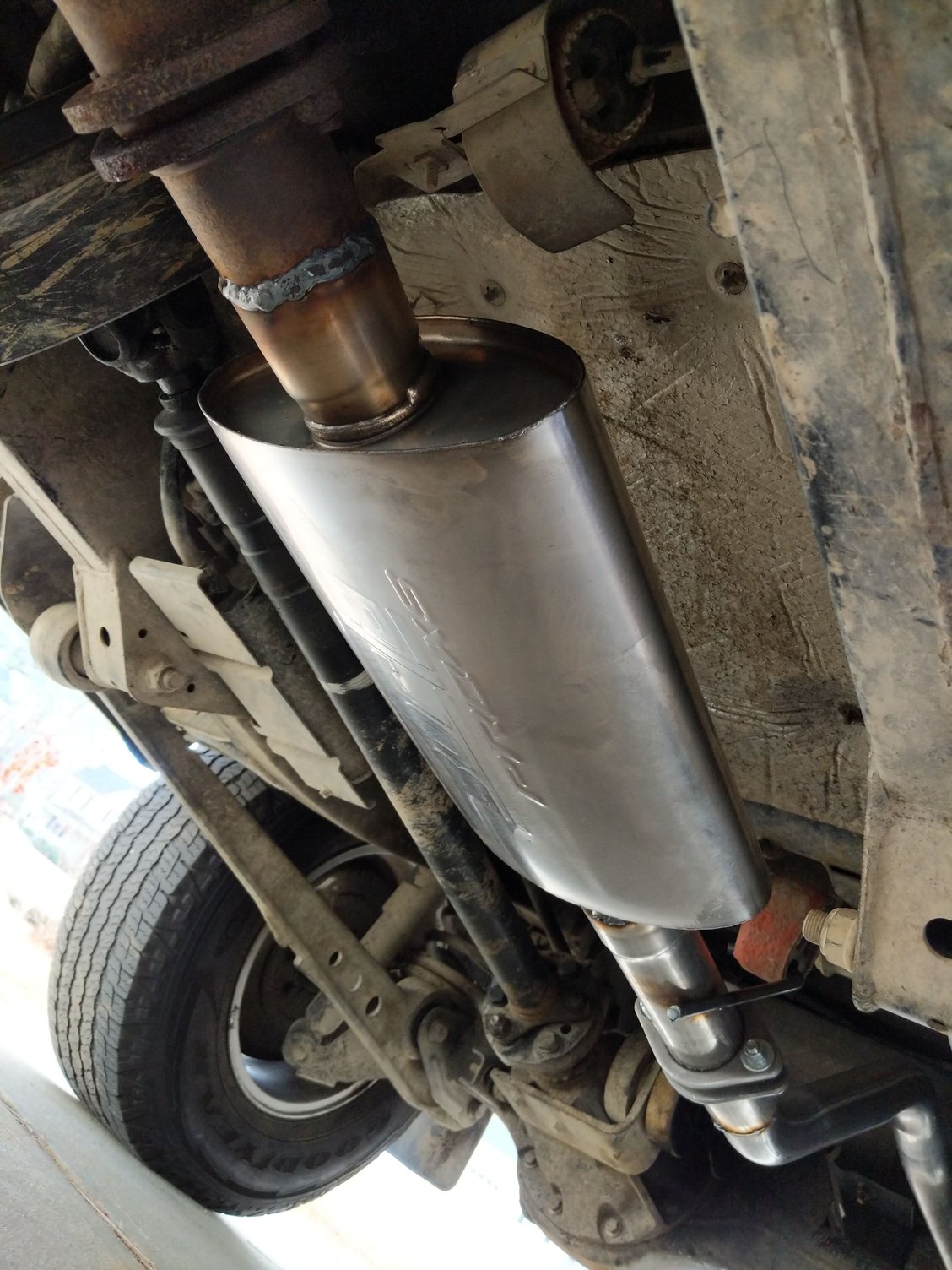

I just went with @best4x4 suggestion of a Borla XS pro, tame with a little growl.
hey sandman... what part number is your Borla?
I looked on their website and nothing comes up for a Disco.
Old Jan 3, 2019 | 07:05 PM
Sandman614's Avatar
Joined: Apr 2017
Posts: 825
Likes: 171
From: Raleigh, NC
It's the ProXS 40363 2.25" center inlet/outlet. From my reading 2.25" matches our pipe and center out allowed me more clearance at the diff vibration dampener. The shop I used did a little bit of ghetto rigging, but it was inexpensive, I got them to add a new bolt flange to remove the rear section, and it doesn't leak.
