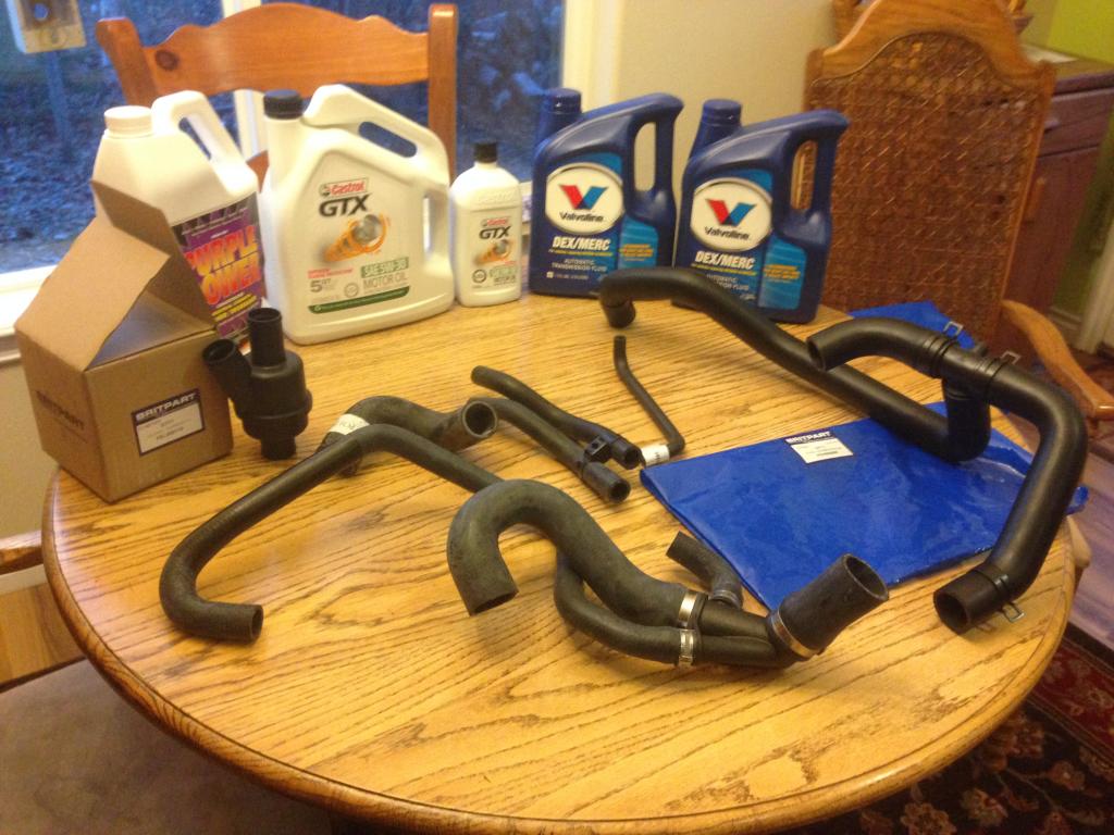

Well half of my orders came in.

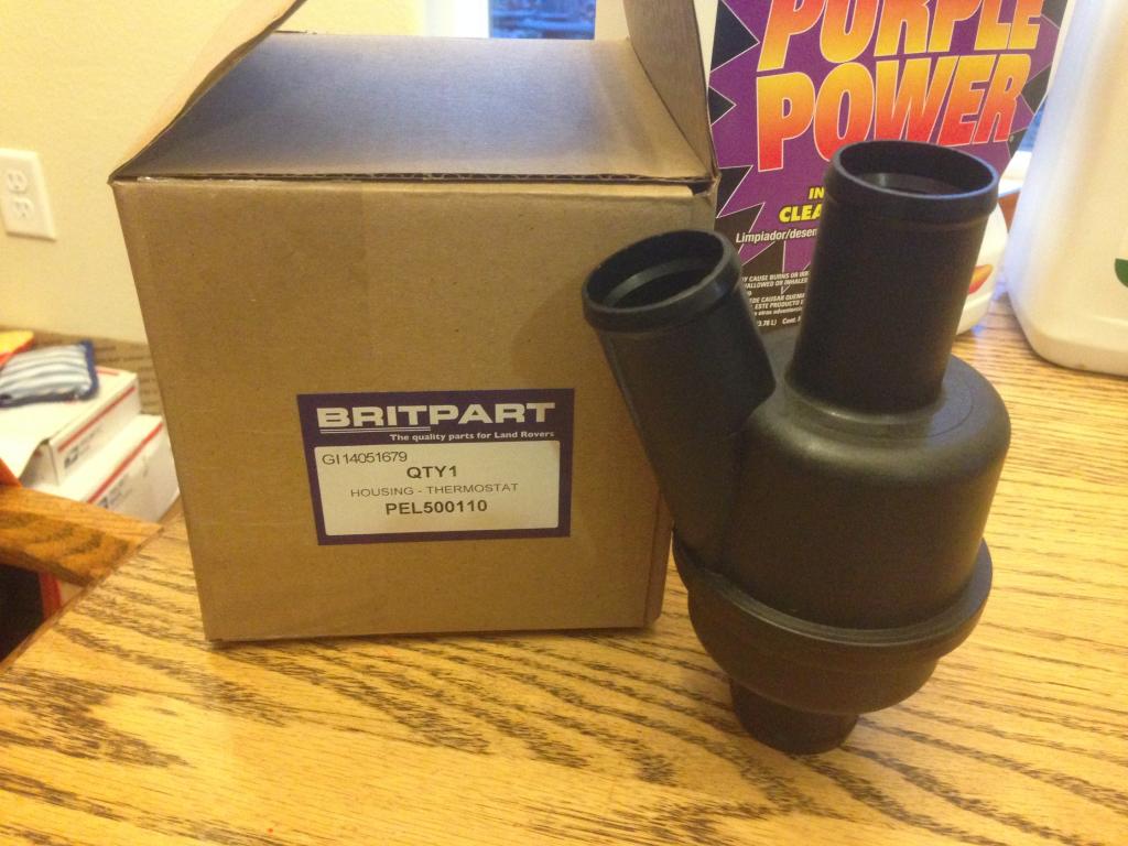

^^ I don't think I've ever seen anyone use this T-stat.
It's the Britpart replacement for the gray 180. Heck it was even listed as being the grey one. It says it opens at 82C, so it's the 180.
We'll have to see how well it does. I liked the price I got it for. All these came in from the UK. Great prices.

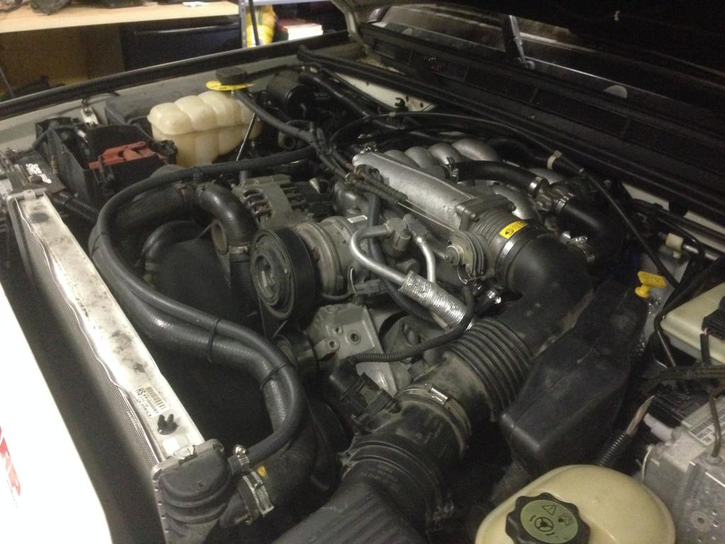

After about 2 attempts, as the fuel lines were bled dry, she fired right up. Then died shorlt after as uh.... well I forgto to bolt the power steering pump to it's bracket. Must have been stuck in there good enough where I didn't know it wasn't.
So, after a run up, we had some issues with running too hot with only water in it. (had a reason for that). We got a few misfire codes on the Ultragauge. 3, then 6, then 5. Cleaned up the plugs, burned off some oil in the cylinders. After a bit of burning off the old gas, and letting the cooling system run, I finally was able to do a 30 minute break in without it hitting 250.
We ran a bottle of Moroso ceramic sealer through it during an hour break in period, then a good hour drive. Temps dropped to 203 running around. Ran nice and smooth. Solid. No more codes. At all actually.
No dash codes. No warning lights. All good. I have to say, I was not expecting that at all. So we dropped the Royal Purple run in oil, and swapped in some 5w-30 dino oil to run it the next 3k miles. Let the seals bed in. Then I'll drop the Rotella T6 5w-40.
Right now the cooling system is bled dry and letting the ceramic set. Tomorrow I'll flush it out and fill with antifreeze. I'll let that run until the new radiator gets here. New radiator, all new lines, and a new 180 t-stat.
I just can't believe she is up and running. Finally. We'll see how it goes from here until I make her the daily driver. For now, I'm getting ready to get married on Friday. I'll finish the truck Thanksgiving weekend.

Your hose routing looks a little unconventional. Where do you have the small hose on the driver's side of the radiator connected to?
Congratulations on getting the truck running by the way.
EDIT: I see how you have it run now. I couldn't see the turn to the reservoir until I zoomed in. Looks good.
