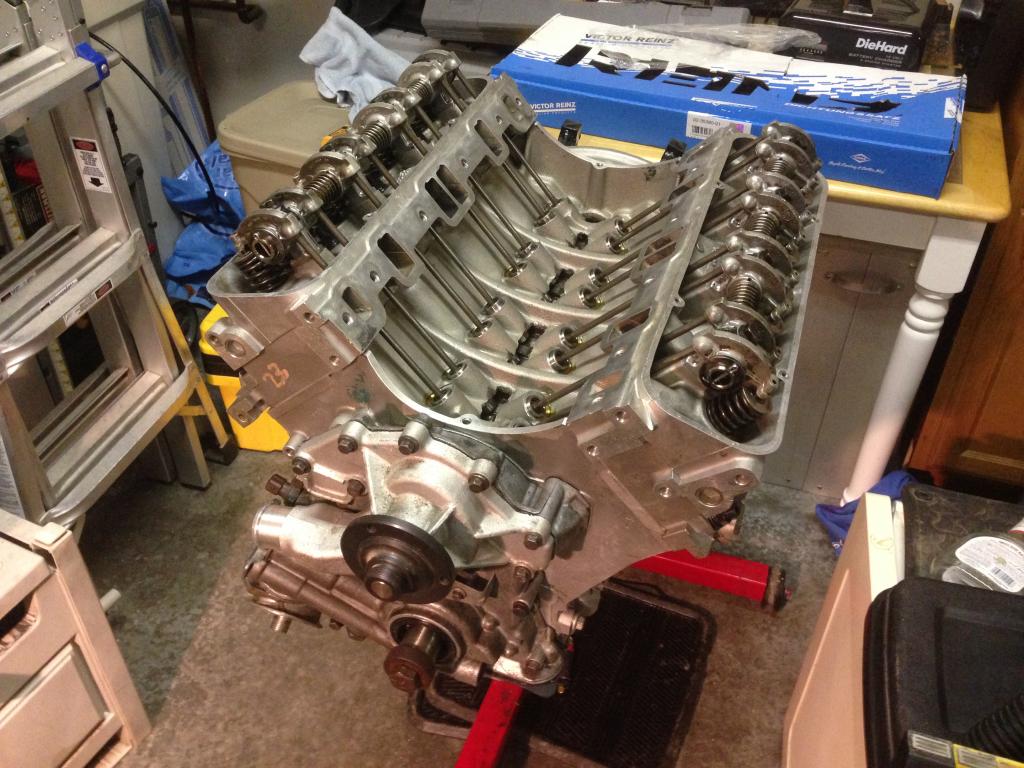

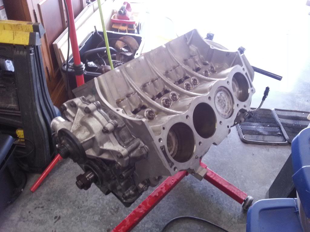

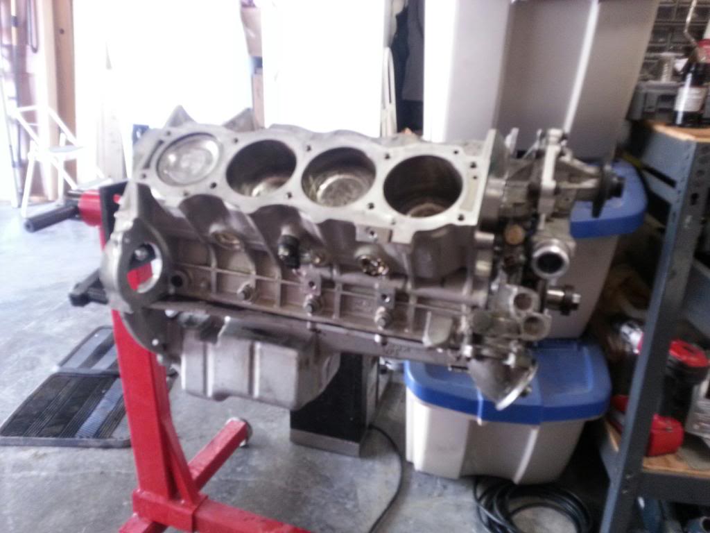

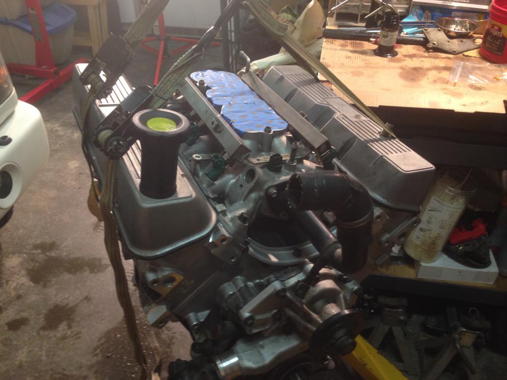

OK. UPDATE.
Bottom end is all back together.
New piston rings, crank and cam gears, new timing chain, all new seals, new main and conrod bearings, crank ground and polished to .010 sizes, tappets inspected and primed, etc etc. New rear core plug. Threw in a block heater while I was at it since this will be in Alaska for a while. Of course all the liners are now pinned as well. Much easier than I thought it would be.
I've also put in a new oil pump, and the water pump was already very new. Threw on a new gasket though. Cleaned up all the pistons.
Everything from the oil pan up is back together. A good dose of oil and assembly lube on everything. Wrapped it all up in a garbage bag to keep FOD out until I get the heads back.
Heads were sent off to the shop to be rebuilt last week. Upon inspection, they found a circle hammered into the deck caused by the slipped liner. Must have been 1/32" deep. You could get a whole fingernail in there. So, it's being sent out to be welded, and then the head will be decked smooth. Then both will be rebuilt. I should have these back in a week or two. Then buy a new flexplate, and an ARP stud kit, then slip this back into the engine bay My nice freshly cleaned engine bay.
Then, as I am not the one who took the whole top end apart, I'll have to piece this puzzle back together. See what needs replaced as I go. I'll be putting in all new coolant hoses and a new radiator and t-stat. I figure I'll just get any cooling related possibilities solved before they ever happen with putting in all new from the start.

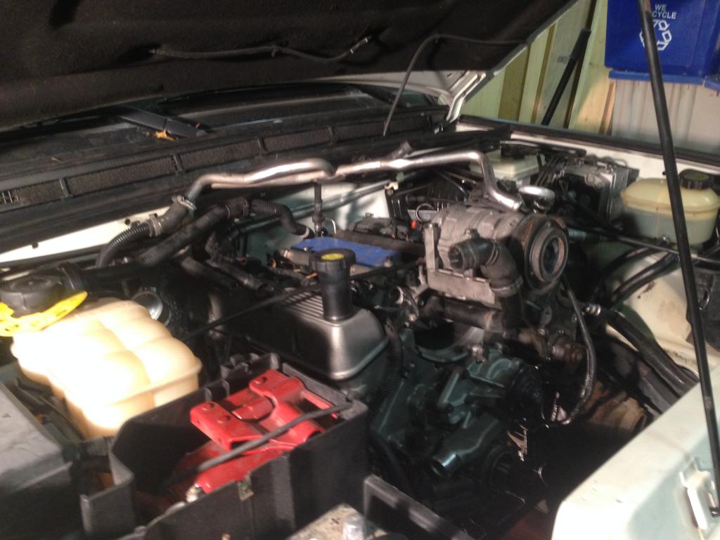

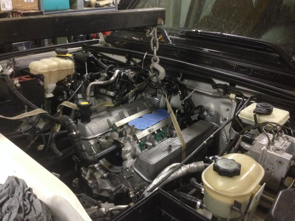

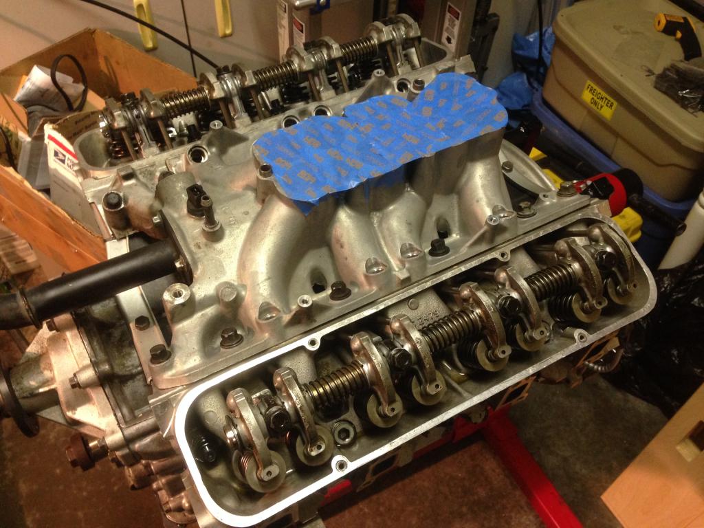

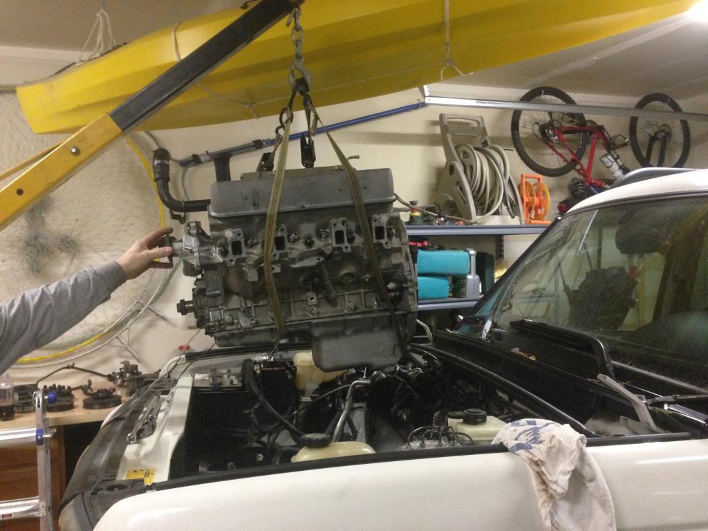

OK OK..... I know I have been super lazy updating this.
Sooo..... the engine is back in the car. I should have it buttoned up and starting it for the first time next weekend.
So here is what ya missed.
ARP head stud kit installed. Picked up the heads that went with the block I got with 77k miles and rebuilt those. Those are back on and shiny. New VR head gaskets installed and all other seals replaced. Engine dropped back in etc etc.
The rest of the parts I needed are ordered and on their way. Nissens radiator, all cooling hoses, couple bolts and rubber grommets lost during the rebuild, NGK spark plug wires, Bosch platinum plugs, transmission filter kit, Royal Purple break in oil, Dex/Merc oil for tranny, and the Britpart Gray 180 t-stat.
Here are some pics from the last few months. I really only finally started hammering this out in the last month. Getting ready for my wedding in three weeks. BUT, I have to get this done before the winter sets in hard.
