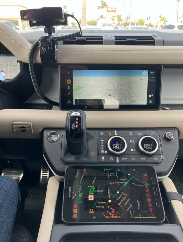

The Valentine One Gen2 is excellent and when the V1 is paired with a tablet via bluetooth that is running JBV1 (a free Android app) it becomes a powerful tool for knowing what traffic enforcement or road hazards/incidents are in your area and on your route.
https://jbv1.net
In addition to integrating the V1's display into the JBV1's moving map display, it also pulls in radar/laser detections from others who are running JBV1 and sharing their data/hits. Other features:
  • Automatic GPS lockouts (requires V1) to filter out stationary false positives from door openers and speed signs.
  • Visually chill out the V1's display in shopping centers with lots of false alerts.
  • Automatic Low speed muting
  • Blind Spot Radar false signal recognition and muting for emissions from Hondas, Acuras, Mazdas, and GM vehicles.
  • Speed Limit Alerts: can display the speed limit right on your device's screen, making it easier to stay within the limits.
  • Weather Information: can show weather conditions, alerting you to potential storms or rain.
  • Aircraft Warnings: using online AVSB data it can detect and display aircraft that are likely being used in your area for speed enforcement and show them on the moving map relative to your position and route.
  • Low-Speed Muting: can configure JBV1 to mute alerts when you're traveling below the speed limit.
  • Automatic Start/Stop: The app can be set to automatically start and stop with your car's ignition.
  • Waze Integration: You can configure JBV1 to launch Waze automatically after JBV1 starts.
  • TMG Laser Jammer Integration: JBV1 can integrate with the TMG laser jammer.
  • Standalone Use: JBV1 can be used as a standalone app for many of its features even if you don't have a Valentine 1 or TMG jammer.
  • Data Logging: JBV1 can log alert data, which is stored in an encrypted database on your device.
The V1 is held in an easy to access position on the dash rail by a clamping type cell phone holder (easy to hit the mute button on an alert and to adjust volume, also fast to take down and put away/hide : ). The power cable is connected to the USB-C port in the dash to the right of the Defender's infotainment screen using a V1 USB-C->12V adapter. You could easily just run the coiled power cable down to the 12V power socket below the dash but I thought this was cleaner. The 8" Android tablet running JBV1 is paired to the V1 via bluetooth and rests pretty comfortably in that nook in the center console (it can slide out of place so YMMV depending on the type of driving you're doing and the size of your tablet). Honestly, there is so much going on with JBV1 the safest way to use it is to have your passenger put the tablet on the dash shelf space in front of them and have them interpret the info for you. Your Android device will need a data/internet connection to use all the advanced features, but it'll work fine if the data is via a smart phone's hotspot connection or the Defender's on board hotspot if you have that activated.
It's really an amazing add on to the V1 in terms of capabilities, bordering on overkill but kinda fun in a geeky/power user sort of way and I'm absolutely astonished that the app is free. There is very active community supporting JBV1 and it's developer, I'd recommend donating money to the guy who developed/maintains/updates JBV1 if you really find it useful.
