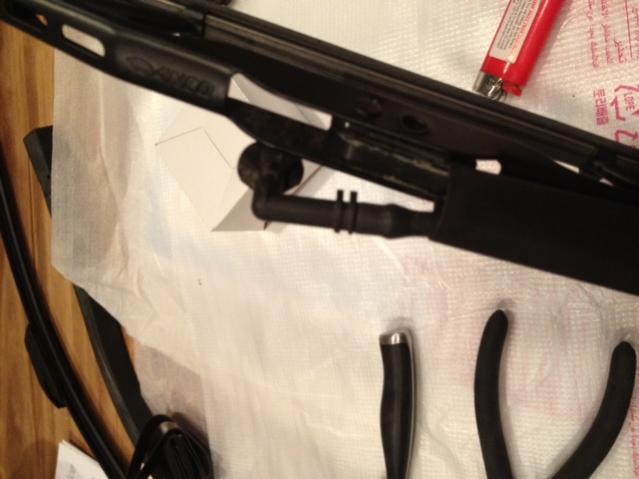

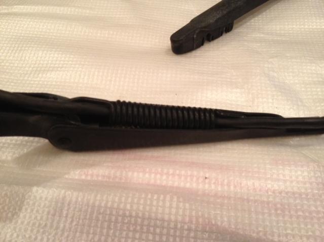

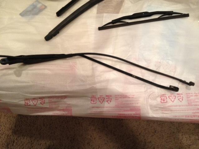

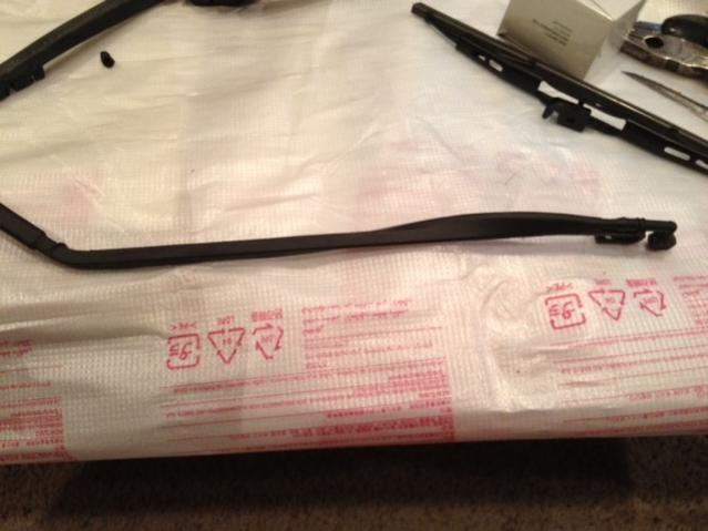

1.) Carefully pry the sprayer and pull the tubing out of the DII arm.
2.) Remove the sprayer. I had to cut the tubing near the sprayer.
3.) Route the washer tubing through the tension spring, along the DI arm, with the end of the tubing nested in the U-shaped end of the wiper arm.
4.) Slide the heat shrink over the arm and tubing. 1/2" will barely slide over the U-shaped end.
5.) Push the sprayer back onto the tubing.
6.) Install a new wiper on the arm.
7.) Pull a little more washer tubing through as needed in order for the sprayer to end up in the empty space in the wiper.
8.) Once the routing and mock-up is right, heat the shrink tubing.
9.) Install the DI arm, splicing the washer tubing with a ****** splicer from the hardware or auto store.
10.) Finish your beer.

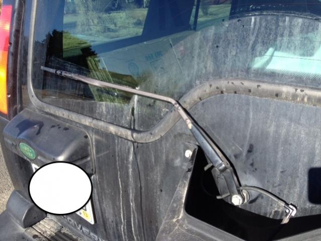

I'm happy that the more acute angle of the DI arm works better with the spare tire carrier flip, since I never got around to notching it.

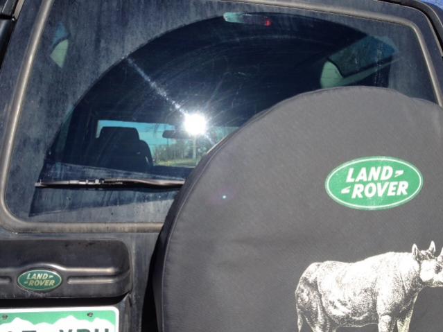

The finished product! And it actually makes contact with my rear glass through it's cycle.
