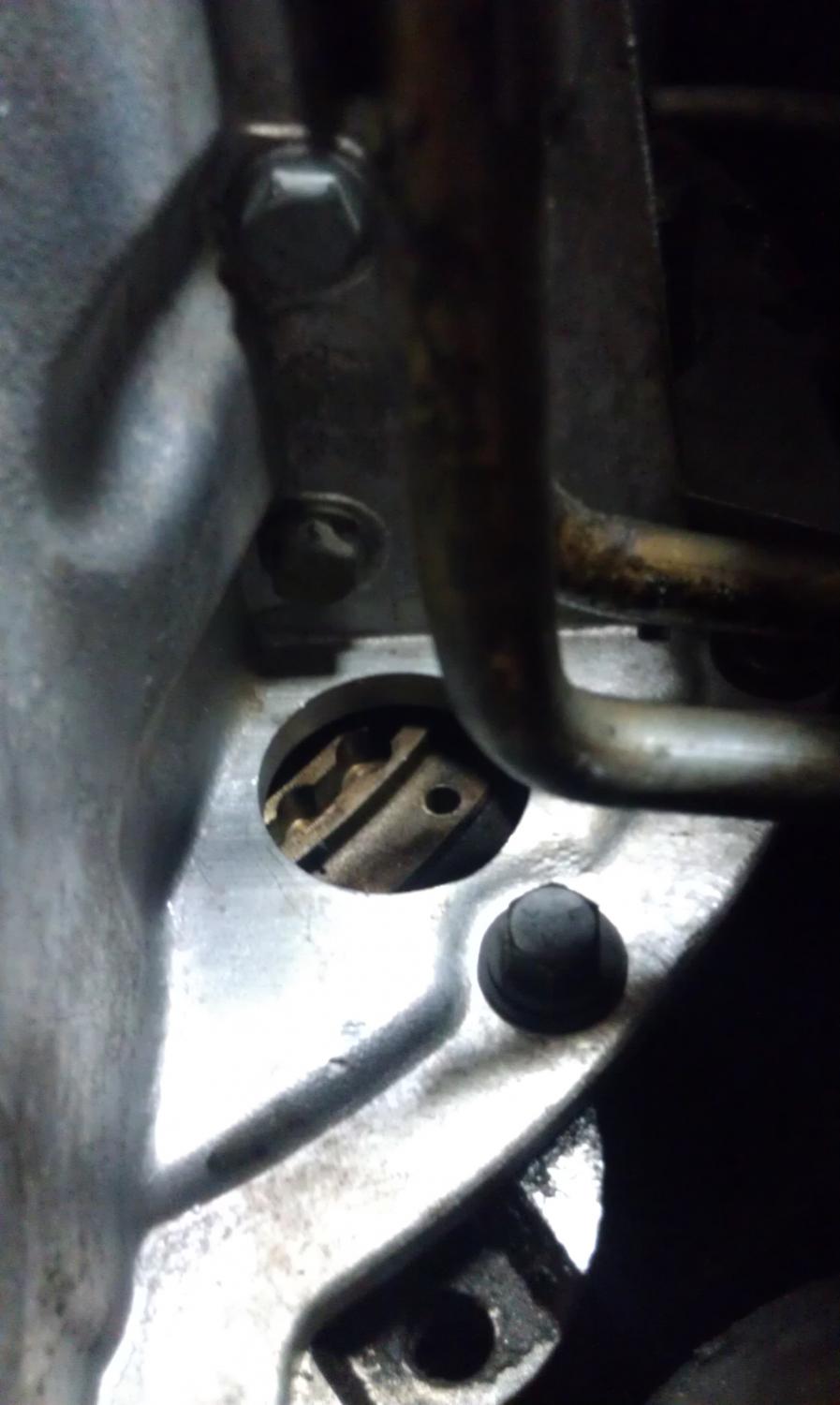

Is there anyway I could have installed the flexplate backwards? I attached a picture taken at the drivers side inspection plate. Is this correct?
Savannah, where is the memory module?
Thanks.

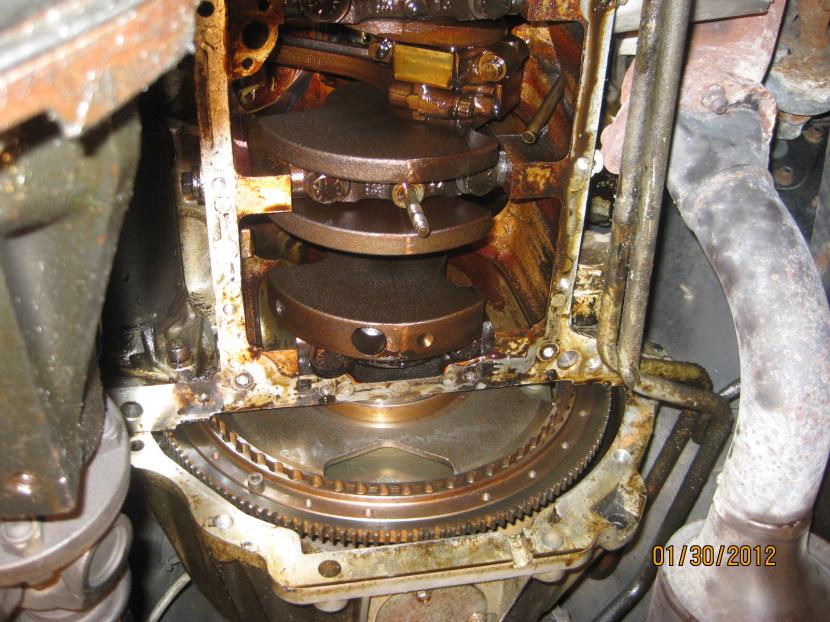

By memory I mean the memory inside each of the ECU units.
Pix of drilled reluctor plate shows you have it facing the correct direction. The Crank Position Sensor tip goes between those drilled holes in the slot.
