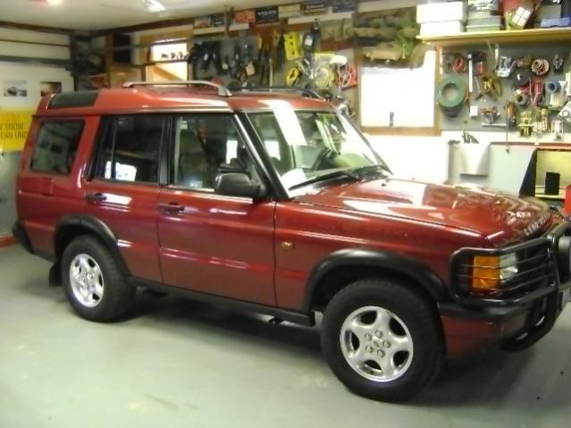

Hello all:
Well I got my first Rover up and running. I picked up a super clean 00 DII w/ a bad tranny for $2800 in February. The PO had driven it until the front driveshaft came apart at the output shaft. It literally beat a hole in the tranny and damaged the transfer case and transfer case cable. In addition there were multiple codes stored for: lean bank 1 & 2, tranny gear ratio, missfires, etc.
A friend of mine here in St Louis owns a salvage yard and had a tranny and transfer case w/ 67K on them for $900. The cable was a hose job @ $245 (Dealer item), a new front drive shaft w/ grease fittings was right at $350 w/ shipping. two weekends and I had it back together. The muffler was also bad so I picked up a Magnaflow 40 series stainless and eliminated the resonator. It definately sounds good and only cost $125 to do.
I cleared the codes and it went about 10 miles before the check engine light came back on. Gear ratio again??????? I wound up deciding that the MAF sensor was bad on the other codes and got one from Atlantic British for around $250 w/ freight. 500 miles and no check light. I guess the tranny ratio was also related, again ???
I went ahead and smoked out the neighboirhood w/ the Sea Foam through the intake, changed the plugs, new air filter, new fuel filter, brake pads, replaced a couple bulbs, repaired the Safari Light relay, and a few other misc issues.
Bottom line is it is way cool for around $6K that I have in it. Thyat may or may not be high for a DII w/ 118,000 on the clock but again it looks new inside and only has a few scratches on the exterior. The PO commuted over 100 miles a day in it so most of the mileage is highway. I never understood the fascination with these trucks but I do now. It is a lot of fun to drive and my 6 YO grand daughter thinks the "way back" seats are "awesome". Hopefully we get a little more snow before summer.
Steve
