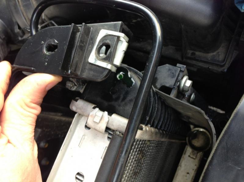

The flood gate of problems is not stopping on my D2, while working on the brakes I noticed coolant leak on the top right of the rad.
A little history, about 4 months ago I repaired the throttle body heater plate, then coolant started to leak from the water pump seals, we got that corrected, then coolant begun leaking from the back of the engine possibly from the valley pan gasket The truck never overheats and I believe it had the head gasket replaced by looking at the bolts. Disco Mike actually offered to help me isolate the leak on the VPG but never connected back with him due to scheduling (Thanks Mike)
So now the leak is springing from the top right of the rad, from what I read it might be a screw and certainly requires a new Rad. I couldn't tell, I walked away pissed but I guess I need to double check.

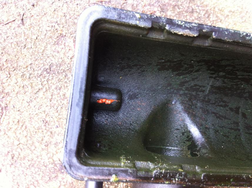

Here's the inside of the radiator plastic with a little crack a member glued. It will last a while, but not forever. Radiator plastic is brittle, plus has a lot of heat cycle changes.
