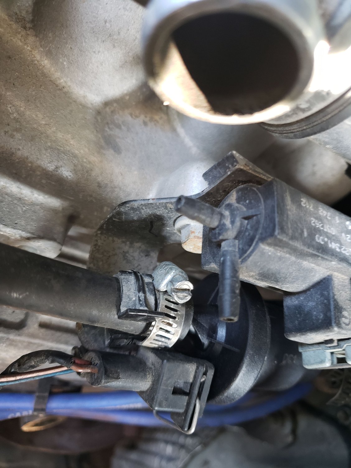

So I put the Hyundai purge control valve on and the unit on top of it has 2 barbs for vac hoses
I don't have a spare truck around to look at. Anybody know where these go to?

You should see a loom that has vacuum lines. The loom splits between the charcoal canister by the abs and goes across the engine to the intake where the other vaccum lines enter on the passenger side. I've never opened up the loom so I can't be certain exactly where they go. Still at work so I can't snap a photo but I hope this starts pointing you in the right direction.

SAI solenoid = little black valve with the nipples. It goes from the nipple on the intake to the valve and then to each SAI stack located on each bank.

That explains it. I pulled that sai junk off during a motor swap.
