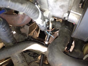

1. photo 1 is a plastic hose coming from back of engine sorta long but, unknown where is goes.

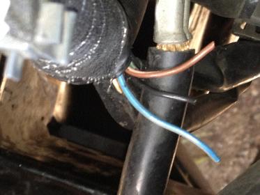

2. photo 2 is a loose wire couldnt figure out what is connected to but i then realized that i only had 1 knock sensor. and missing one on drivers side so I ordered it. assuming this wire goes there? if so, where do i bolt the ground to?

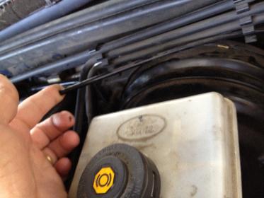

3. photo 3 is another plastic hose but its clipped itno a clip on the firewall was disconnected, does it even connect to anything?

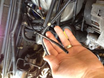

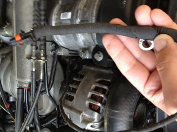

4. photo 4 & 5 is im hoping my missing plug for my camshaft sensor. dont know how that wire got cut but I ordered a plug and will be soldering wires to make a plug for the camshaft sensor. can anyone tell me which wire goes where? its a 3 prong connecter standing in front of car which colors in order from closest to farthest from you? if anyone can tell me this I owe you one

Black plastic hoses - usually vent lines from axle and transfer case
See pix of connectors you searched for. Ground lug can go anywhere that is a metal frame point. Wire colors in the CMP plug are black (1), slate with blue (2), and brown with pink(3).

As far as the. black hose, all the vents end up by the firewall, this one is a little long. Not sure if it is but could be i guess. So just U turn it and just stick it back down the firewall?

i forgot to mention vent from auto transmission.

On the first one, are all the expansion tank and throttle body heater lines accounted for?. The other looks like the axle breather. Cant really tell from the other wire pics

On the intake there is one that just plugged in there on the very top passenger side, what and where is the expantion tank?

Expansion tank is the coolant reserve jug. Do you have coolant coming out the mystery line? See attached from RAVE for coolant flow path.

No, there is no coolent coming out of mystery line. But offnote, was sort of weird to me but why is there coolant going to throttle body anyways? I have a line going from expansion tank to throttle body. Its hooked up and working but never seemed like a good idea to me?
Unless its for like a insulator to cool off throttle body?
There is no vacumm or water coming out of mytery line.

it is to keep the throttle body from freezing in the open position, in the winter.
0 degreee air and 70 mile and hour wind leads to some pretty low intake air tempertures
