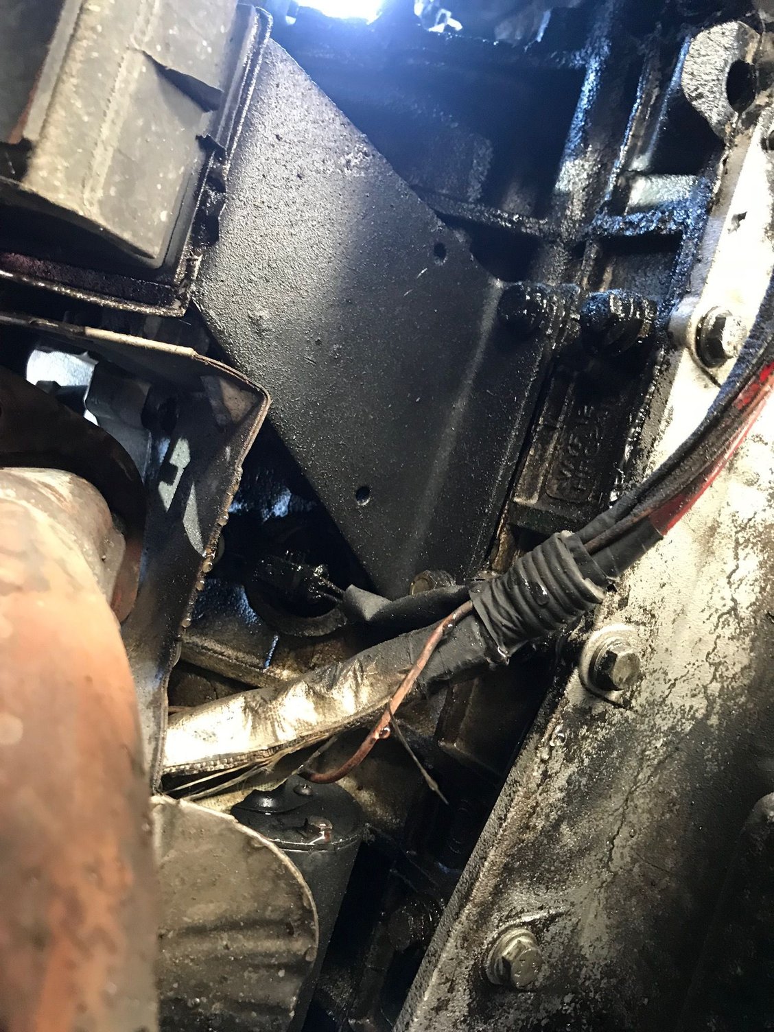

Back to square one. It looks like I fixed the drivers side head gasket, but still leaking like a sieve. I hope you can see from the picture where it is coming from. Looking up from passenger side tire where the exhaust manifolds connect. Right above the sensor, there is a hole that water pours out of.
I guess I had more than one leak.

Block plug missing?

This has been in the driveway, wasn’t sure where it came from. How would you replace one?

Just Googled and found my answer. Can I hammer this one back in, or should I go order a new one?
I was hoping to get this thing running this weekend. On the positive side, the head gaskets needed to be done anyway.
