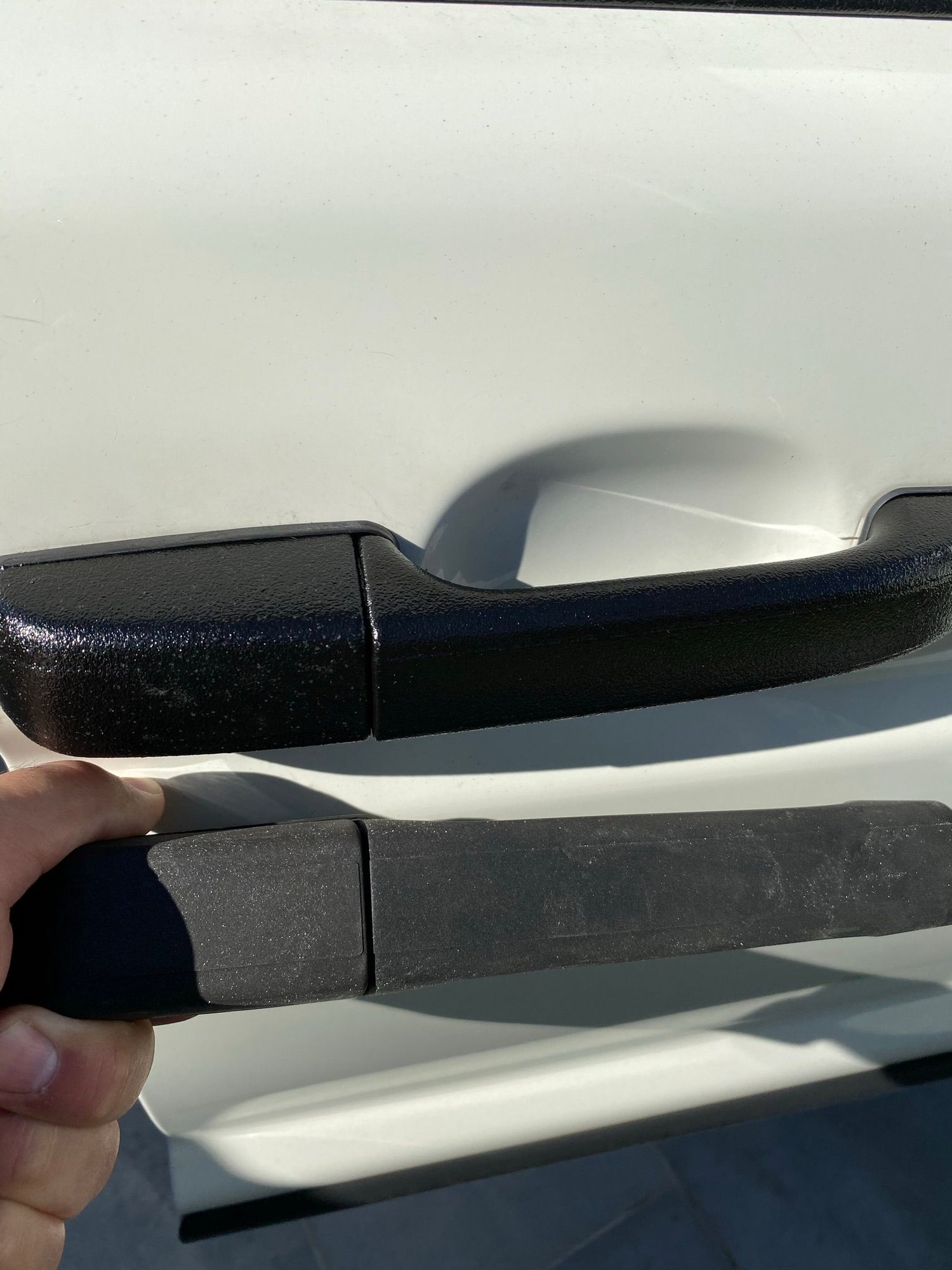

Just wanted to update on this in case anyone has to replace anything in the rear passenger door. Watched a few YouTube videos that were workarounds for removing the door window frame making me think that was something difficult and you want to avoid. Going so far as to show in one video to bend the access hole lip to remove/replace lock actuator.
Knowing now how easy it is to remove the window frame. About 10 minutes and allowing plenty of access for internal door handle connection and actuator etc it is definitely way to go. Lack of videos or write ups on this tell me not many people are doing this or I am indeed a bit slow minded and this is a no brainer for everyone !!
What I was doing removing the door handles is having them painted with Line-X coating. Always bothered me how old the plastic made the truck look and not just Land Rovers. I do think using a spray can would probably yield somewhat same results that a Herculiner type spray would do and be a lot cheaper. Will see how this ages. My OCD took over during this process and I had a bunch of trim pieces done.
