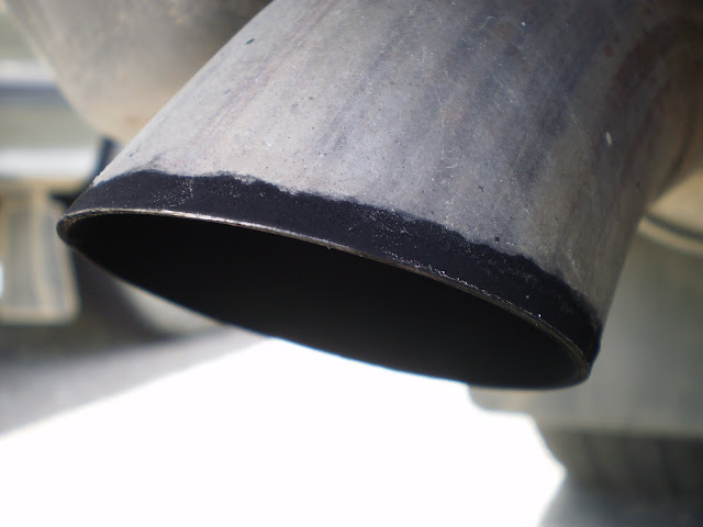

He then tells me that he has noticed a black ring around his tail pipe

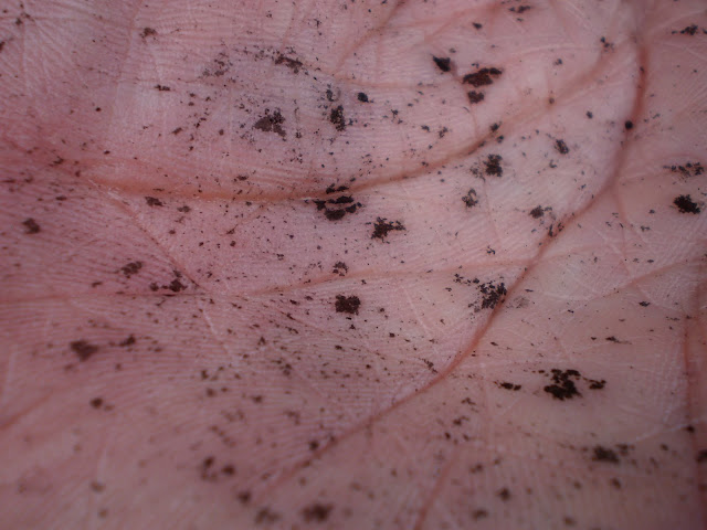

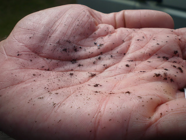

And when he puts his hand at the end of the pipe, his hands get like this

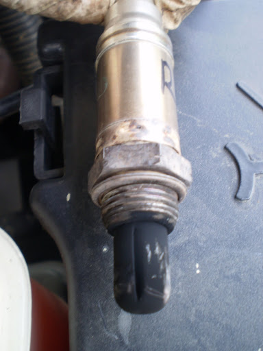

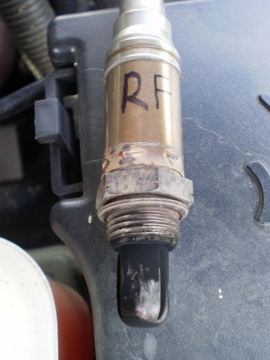

Yesterday I went and removed his front right O2 Sensor and replaced it with mine. (hence this thread) O2 Sensors Look Good??
But I noticed there was a fair amount of oil INSIDE the O2 sensor connector so i used electric connector cleaner and cleaned it out.
Maybe the oil leak destroyed the O2 Sensor?

So I remove the right front O2 sensor from his rig (my O2 sensor.....)
(I accidentally touched the tip that is why its not ALL black)

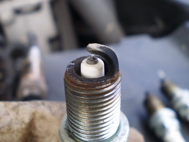

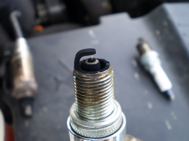

Then I remove the #2 and # 6 spark plug respectively
then I removed the #1 spark (bank 1)

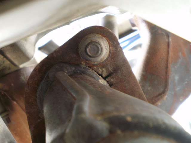

While I was reinstalling his original O2 sensor I noticed this carbon spray coming from the weld of the Y pipe flange
is it Cracked??

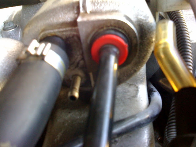

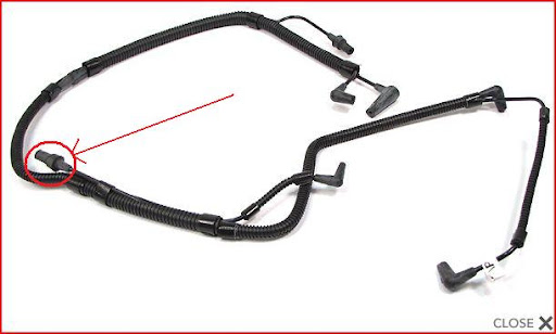

Also there is ONE vacuum leak at the manifold which I repaired a month ago but the tube has expanded... it is coming from here.
This tube circled red is what plugs into it
But the rubber gromet has expanded and it no longer fits snug. That is why you see a small piece of clear tube inside of the gromet.

since you have a good running parts truck try swapping in the MAF .
Fix the vacuum leak the rubber may have gotten some of the intake cleaner on it and its now lost its elasticity and has expanded you might try to put a piece of heat shrink on the end with it off the port maybe even a few layers and then fit it onto the port.
The exhaust/ header manifold is cracked

His truck is running WAY to rich and that is why he is getting the carbon bits and the black tailpipe.
You need to fix the vacuum leak, use a small zip tie to tighten the loose hose onto the nipple, it will be a simple and easy test before you spend any real money.

I have heard of coolant and oil affecting O2 sensors this way.... but didn't think it could really happen til I disconnected the connector and saw oil inside.
Oh I see. I thought oil had fouled the O2 sensor, which didn't make sense because of the picture.
Running rich will deffinitely cause excess carbon. But the black you have on only those spark plugs tells me its oil burning and not just running rich. If it was running rich all of the spark plugs should be dark and not just a few. It could possibly be a bad vavle seal causing oil to leak into those cylinders. I would hate to think one with that few of miles would go bad, but it is possible, and would require the head to be taken off and have the vavles redone. But that is just my assumption from past experience with other brands of vehicles.
