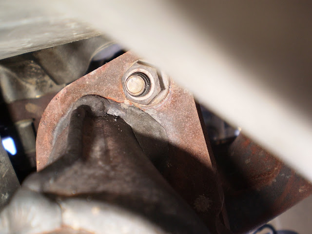

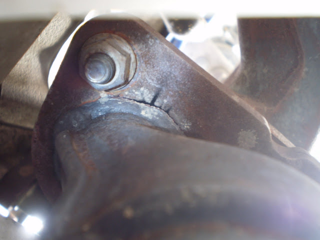

I fixed the vacuum leak at the manifold and JB welded the crack.
It started to idle a lot better. I will check the JB weld on Monday and Wednesday and if it holds up, I will order O2s and plugs.
I think these two are the culprits causing bank 2 to run lean, then dumping in fuel to correct the air:fuel ratio and there by fouling the O2s and the plugs.

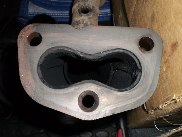

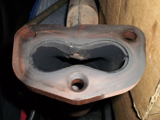

The JB Weld fell off so I took the Y pipe down and will take it to get welded tomorrow.
Question:
There is soooooooooooooooooo much carbon build up inside the exhaust manifolds, the Y-pipe, and the rest of the system... Im afraid new O2's and spark plugs will get fouled.
Is there anyway that it can be cleaned?
Or will it all burn off and get pushed out?
Could there be damage to the cats? Will he need to buy another Y pipe?
This $hit is caked on like flour all over the inside!

You can tap the pipe before the cats with a rubber hammer with the pipe upside down to get anything loose off. This will also get the stuff that has fallen into the cats. Don't worry about post cats. It should all burn off though...

1. Exhaust was welded and repaired ($25). Stud broke off inside manifold so I had to drill it out and re-tap it and everything went smooth. Used two new gaskets and two new studs. I tapped the Y pipe with my rubber mallet a few times and nothing came out.
