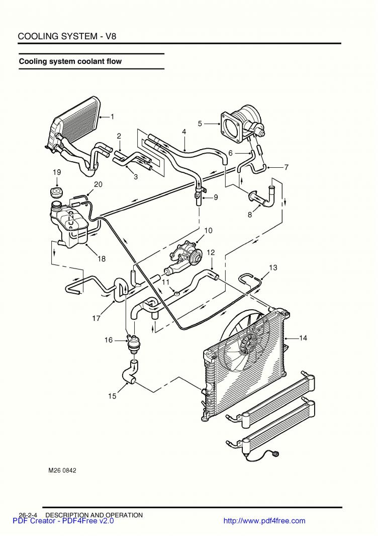

The stat design precludes an air pocket, it has holes and cavity ports, etc. Here's the plumbing chart.
Attached Thumbnails Need help w T Stat install-d2-coolant-flow-001.jpg   Need help w T Stat install-land%252520rover%252520thermostat%252520005.jpg   Need help w T Stat install-d2-stat-internal.jpg

Perhaps I was overly cautious... Just got back from a drive, never got over 197. Quite pleased.
