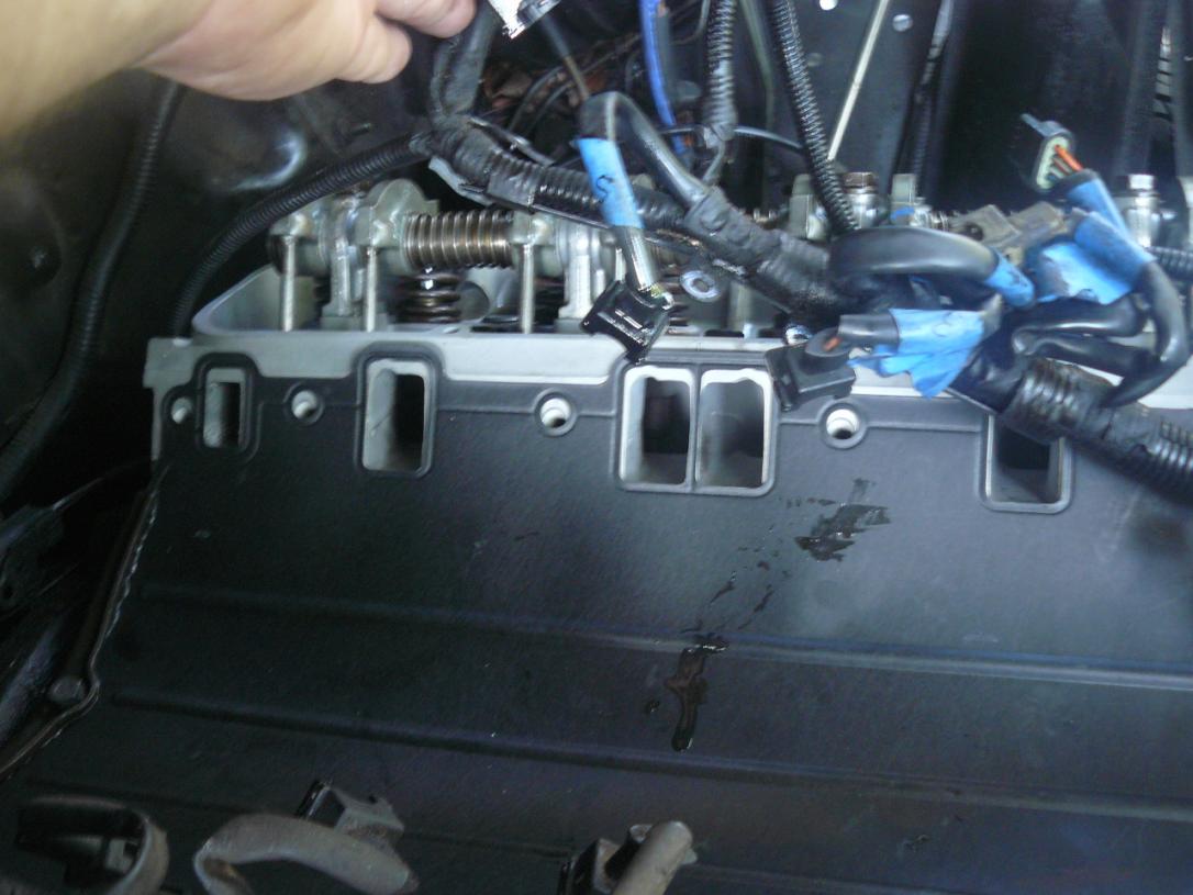

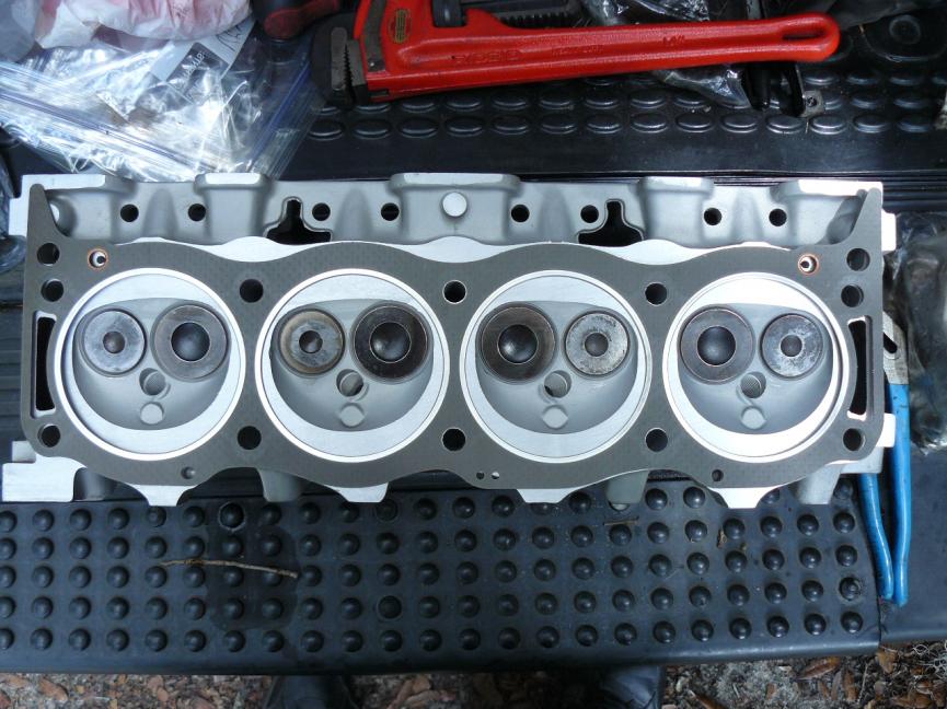

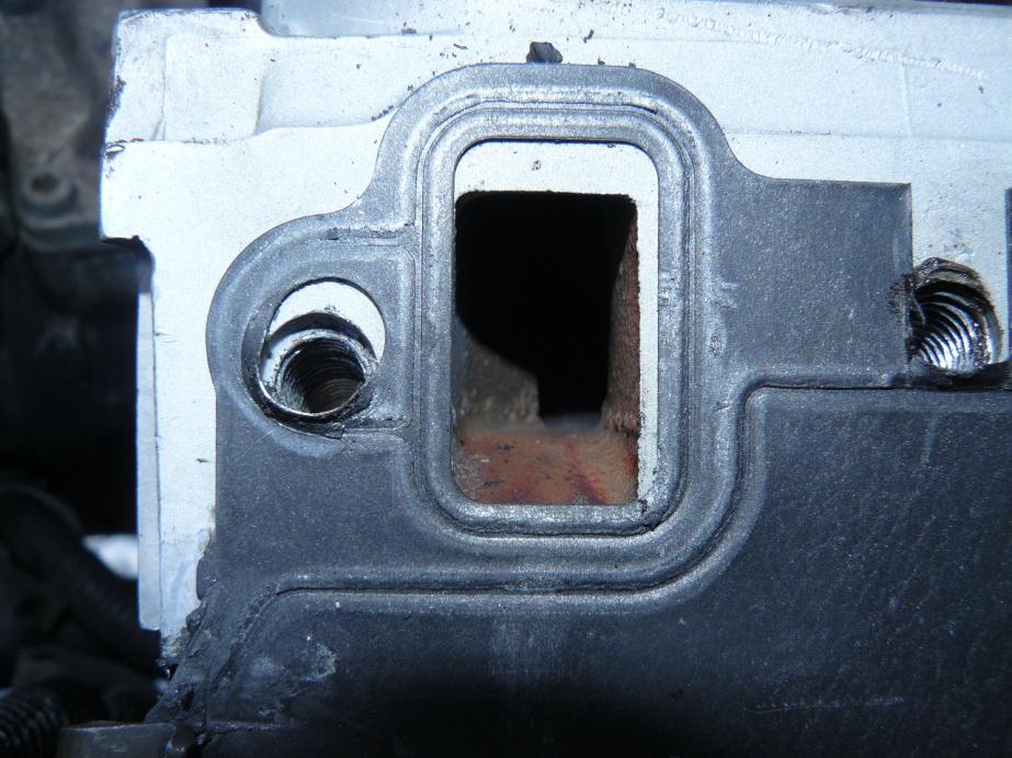

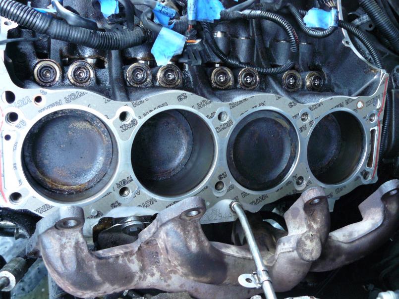

The intake being shifted .002 would be hard to see. Here is the alignment I'm fighting. You have to push down firmly in the middle. I have been told that if the heads are in place, but not torqued, the index pins for them allow some wiggle room to improve things.
