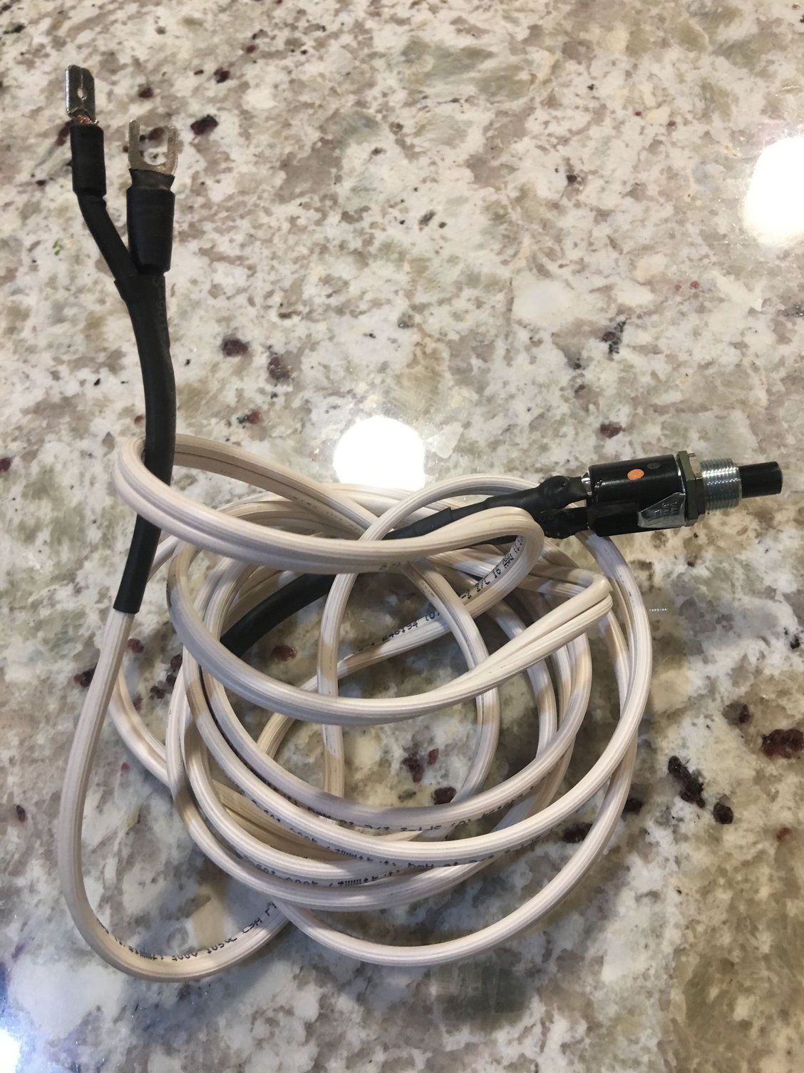

You don't necessarily need an expensive Testbook to actuate the ABS module to help you bleed your brakes. You can google to find certain less expensive OBD diagnostic/scanner/code readers can do this task.
The cheaper route that I use to actuate the ABS module:
- get 8 feet of doubled speaker cable or a lamp power cord
- connect 2 wire spades to one end of cable cord
- then attach the other end of the cable cord to the terminals of a normally open (NO) pushbutton switch

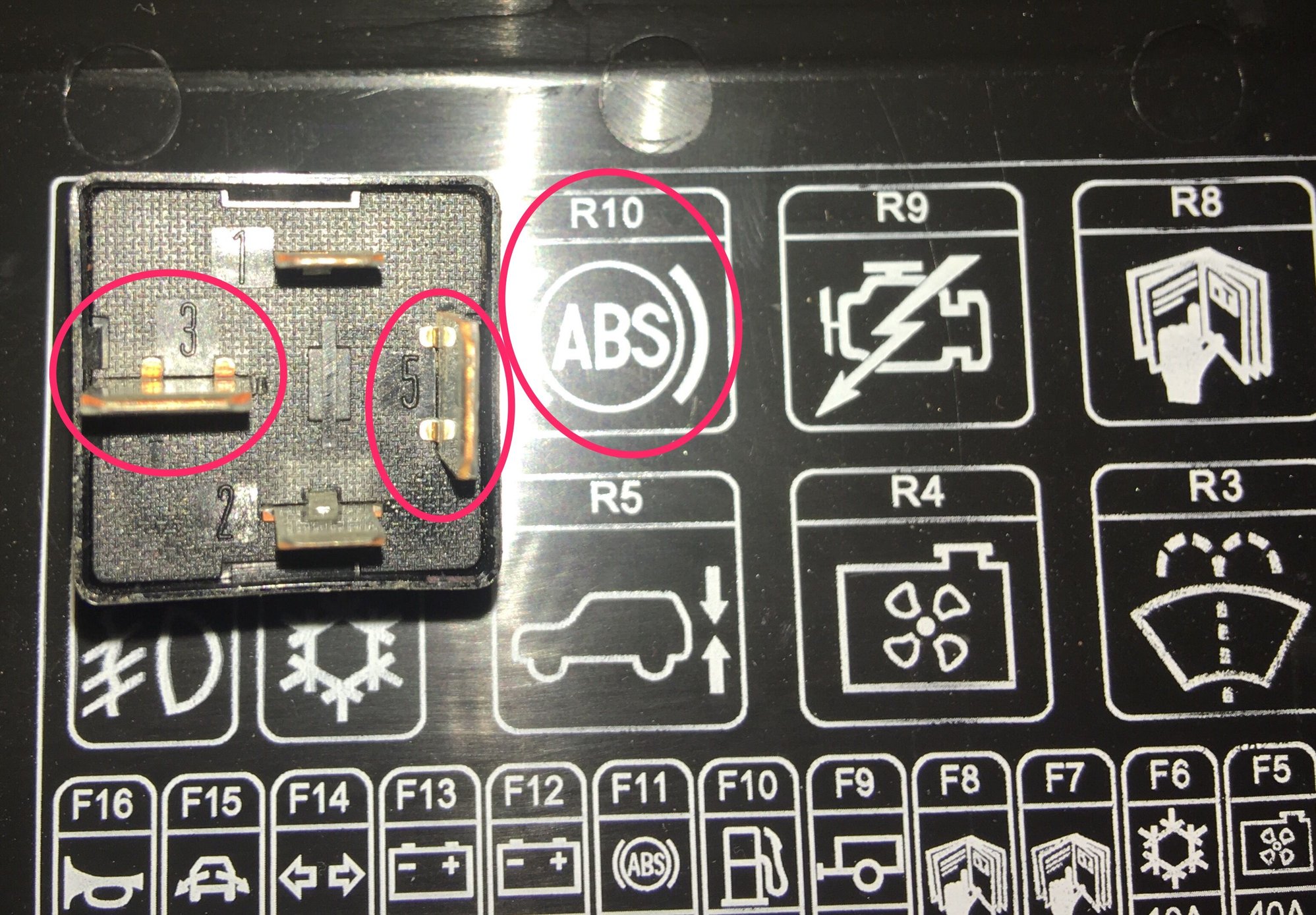

- Remove ABS relay R10 in the engine bay
- insert the spade ends of the cable cord into the #3 & #5 female socket of R10
- turn ignition on
- while bleeding brakes, momentarily press push button (10 seconds max) on cable cord to power and actuate the ABS module.

The above is the reason I suggested activating the HDC to bleed the ABS, its way easier than fabricating a set of jumper cables from speaker wire.

That's cool. I'm just adding another option that has worked for me and others.
- turn ignition on
Wow this is foreign to me, no all we did was take each wheel off and let the air out of the brakes like that. And of course didn’t get the back passenger side bc it’s the one w the stripped bolt but have new calipher on the way 2moro so that it can be replaced
But I will say you are really freakin crafty to have done that, I mean your directions are step by step I may just try it but again I’m not as handy as you all male guys. I try lol but this bastard is starting to defeat me. I do have one local place I found that the owner only works on Rovers and BMW so but I’m about betting he would be way out of my price range for the moment. Too bad none of y’all live in TN! Lol. As I know most men would put some work in for a home cooked meal and a 6pk of beer 😂 kidding kidding but yeah Idk what I was thinking when I bought it. I do love it just wish I could get her back to running smoothly 😭
