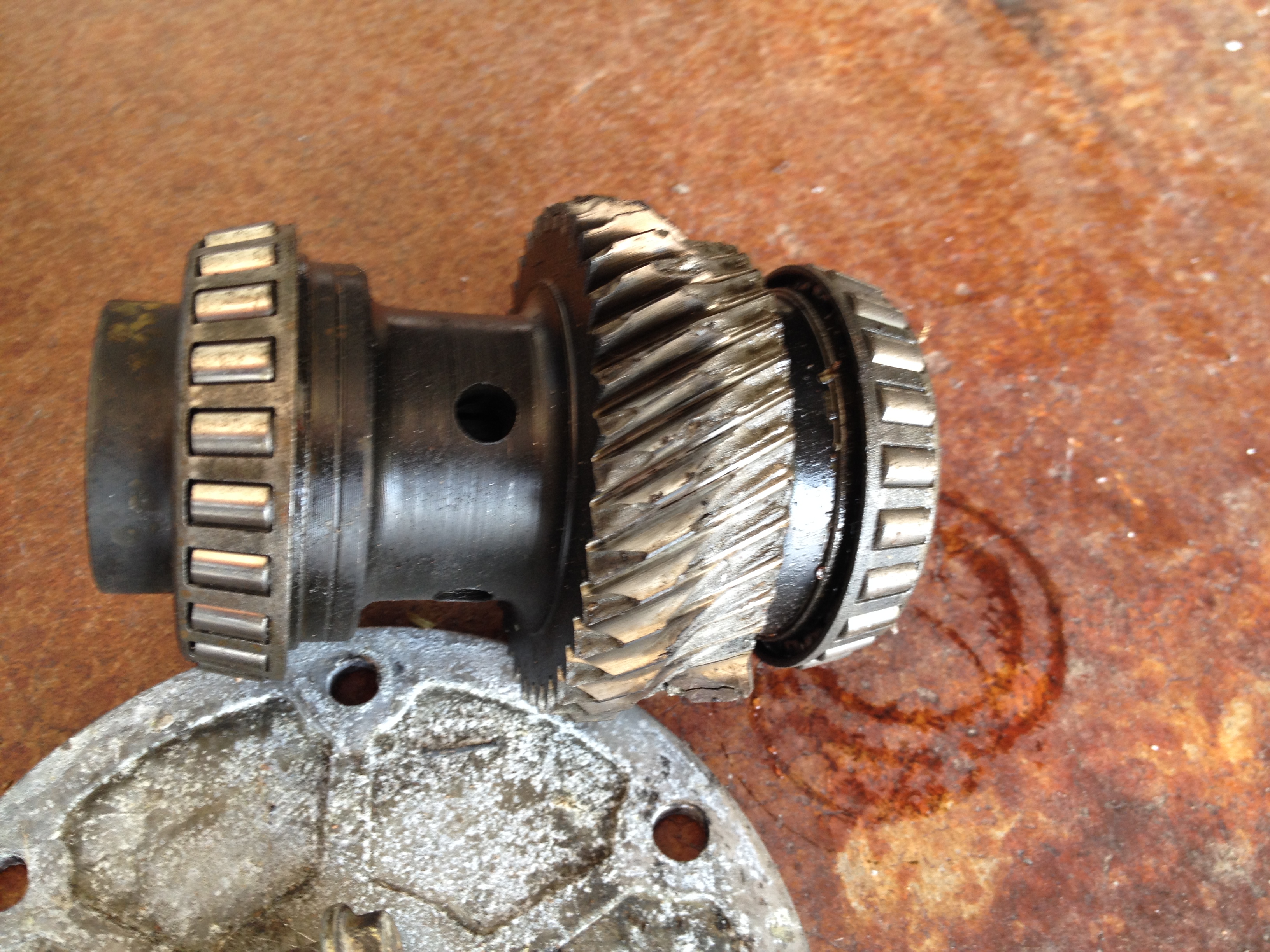

Gear Carnage. You can imagine how that sounded going down the road.
Attachment 27234
................. I've never, ever seen a lunched transfer gear that bad in 45 years. It looks like a bearing failure or something has been floating around inside the case. To me that is unique fortunately but unfortunate for you.
